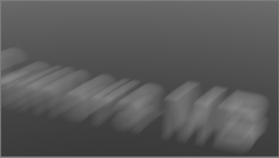

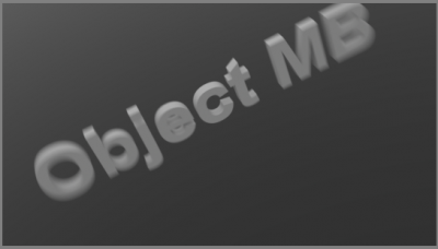

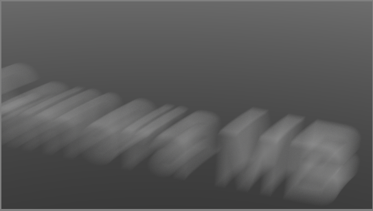

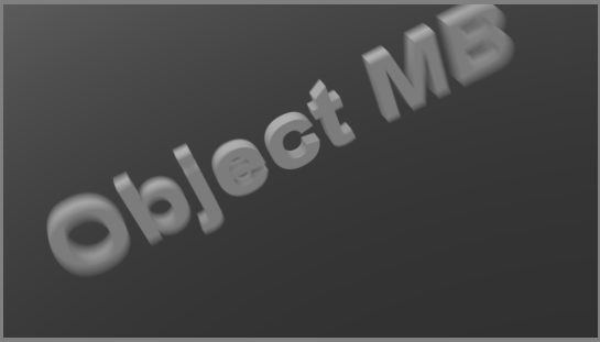

Hey guys,
I was doing some tests with motion blur (related to another thread), and I can't seem to get any kind of vertex motion blur working on deformed meshes.
I exported this orbx from modo. The animation uses 3 items. In the first part, Im rotating an item and we see object motion blur working
Then in the second part, Im moving the camera, while the item is still. We have working camera motion blur.
At the end I have a static camera, with an animated deformed mesh, but no motion blur is rendered. I'm not sure if this is a bug in octane, or the modo export.

Is it working in Modo? I had a look at the exported scene and the scene isn't exported correctly for vertex motion blur to work (because there are no vertex speeds provided and mesh is not marked to have a constant topology either).funk wrote:Hey guys,
No, the modo plugin never got vertex motion blur working. We always had to export out to orbx.abstrax wrote:Is it working in Modo? I had a look at the exported scene and the scene isn't exported correctly for vertex motion blur to work (because there are no vertex speeds provided and mesh is not marked to have a constant topology either).
So the modo plugin is just exporting things incorrectly? I have sent the scene to Paul as well
Win10 Pro / Ryzen 5950X / 128GB / RTX 4090 / MODO
"I am the resurrection, and the life: he that believeth in me, though he were dead, yet shall he live" - Jesus Christ

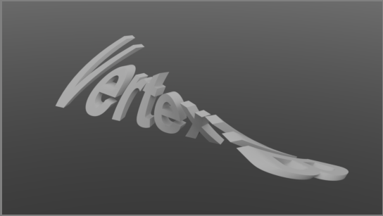

I just installed an older build of the modo plugin and the exported orbx has vertex motion blur working.abstrax wrote:Is it working in Modo? I had a look at the exported scene and the scene isn't exported correctly for vertex motion blur to work (because there are no vertex speeds provided and mesh is not marked to have a constant topology either).
So it looks like a recent regression in the modo plugin. Thanks for checking and sorry for wasting your time.

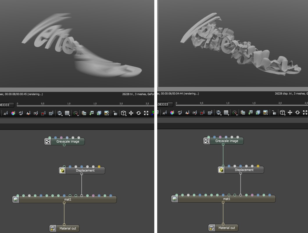

Now that I have vertex motion blur working, I can test what I was initially trying to test... which is vertex motion blur with displacement (someone was asking here: viewtopic.php?f=23&t=68940 )
It seems vertex motion blur stops working if you connect a displacement texture
If you load the orbx, go to about frame 75, there is no vertex motion blur. If you disconnect the displacement texture, you can see vertex motion blur works.

Yes, that's a limitation at the moment.funk wrote:Now that I have vertex motion blur working, I can test what I was initially trying to test... which is vertex motion blur with displacement (someone was asking here: viewtopic.php?f=23&t=68940 )
