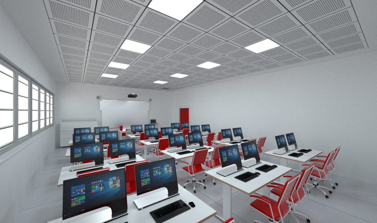

we have a problem with emitter panels on ceiling.
with beauty denoiser we havent glow effect as in no denoiser.
see the image in attachment.
Best regards

nico_cad wrote:we have a problem with emitter panels on ceiling.
Best regards
This can be a limitation of the denoiser, probably something that will be fixed in an upcoming build.
Thanks,
-Juanjo
Best regards
Glow effects should work fine. Could you please send me the scene for testing?.

Thanks for answer Juanjo.
Sorry cant share scene because are all object from collection.
