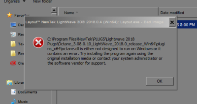

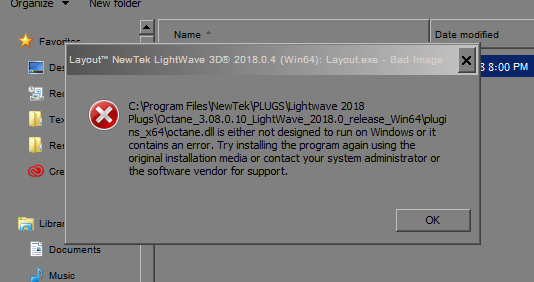

Hi
I am trying to use Octane in 2018 but it is not letting me install the plugin. I've got 2015 redis installed. I've uninstalled it and Lightwave numerous times, restarted,etc.
I've included a screen shot of the bad image popup. Does anyone have any ideas?
Mike

stoecklem wrote:Hi
Mike
So do you say that you have LW2015 on this same computer and Octane works fine on it? It is weird ... this problem can be related to the lack of the Visual C++ 2015 redistributable package, but this should affect also to the 2015 plugin.
Thanks,
-Juanjo

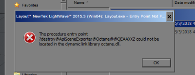

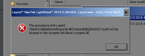

stoecklem
Posts: 9
Joined: Mon Nov 15, 2010 7:35 pm
It can't be added to the 2015 version either. It gives a different error popup.
Mike

Hmm, how are you installing the plugin? It seems that you could have mixed Octane.dll/.dat files and plugin .p files that are not from the same version.
Currently, you don't need to copy anything to the LightWave/bin folder. I fact you should remove any Octane.dll or Octane.dat files that you could have in LightWave/bin folder. All the Octane files are now located in the same directory used by the plugin .p file, and you don't need to copy them to another place.
Thanks,
-Juanjo
