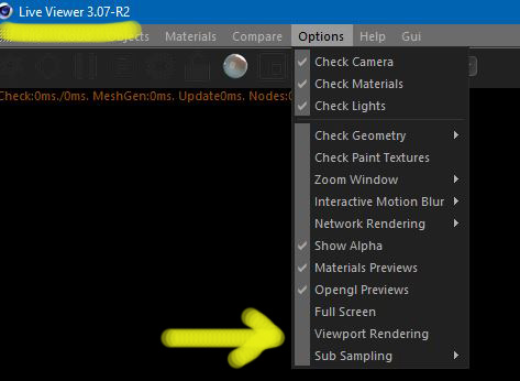

One small thing I noticed...
The Live Viewer window says 3.07-R2 in the window bar at the top. But I am definitely on 3.08. I even have the option for the viewport rendering (which works well for me.) Guess it's really a cosmetic fix.

BCres wrote:This version works well for me.
If your window is part of a saved layout you have to close it and open a new Live Viewer window.
Thanks, niestudio. That was the problem. I learn something new every day.
