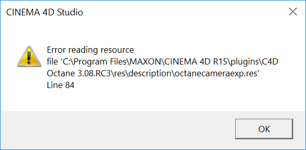

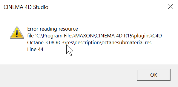

Error Msg Blend Material (R15 + 3.08.RC3)
Error Msg Camera Object (R15 + 3.08.RC3)

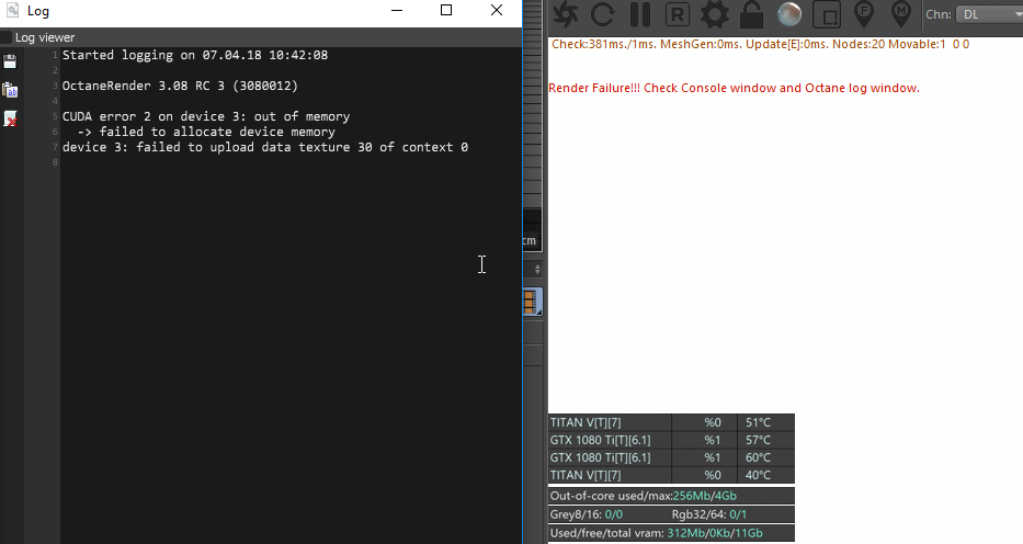

Hi, I was using Red Shift but wanted to give Octane another try. Updated all of my NVIDIA drivers, and the most recent 3.08 Octane. Here is the issue I keep having which make it unusable.
