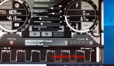

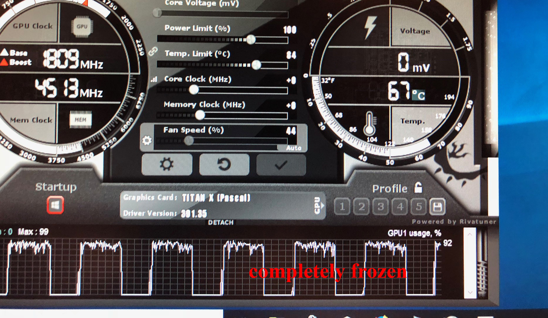

Almost after each rendering session my pc with ASUS ROG RAMPAGE VI EXTREME (it has 3 x 1080s and a netstor box with 4 x 1080s) freezes to where nothing moves or afterburner shows no GPUs and windows says nvidia failed to start. PC must be restarted after this. It seems that the problem is even worse when rendering Phoenix fluids. I tried all the drivers and have the latest BIOS. Not sure what else can be updated. All other PCs work fine. I guess shouldn't have bought asus board. Thanks

Same issues on the RedShift forums. I have confirmation that Nvidia is aware and actively working on the problem. The cause- specifically the PLX feature in Asus X99 motherboards. Anyone else who is having trouble should send a support ticket to Nvidia to speed things up and keep the pressure on them to get this resolved soon.
