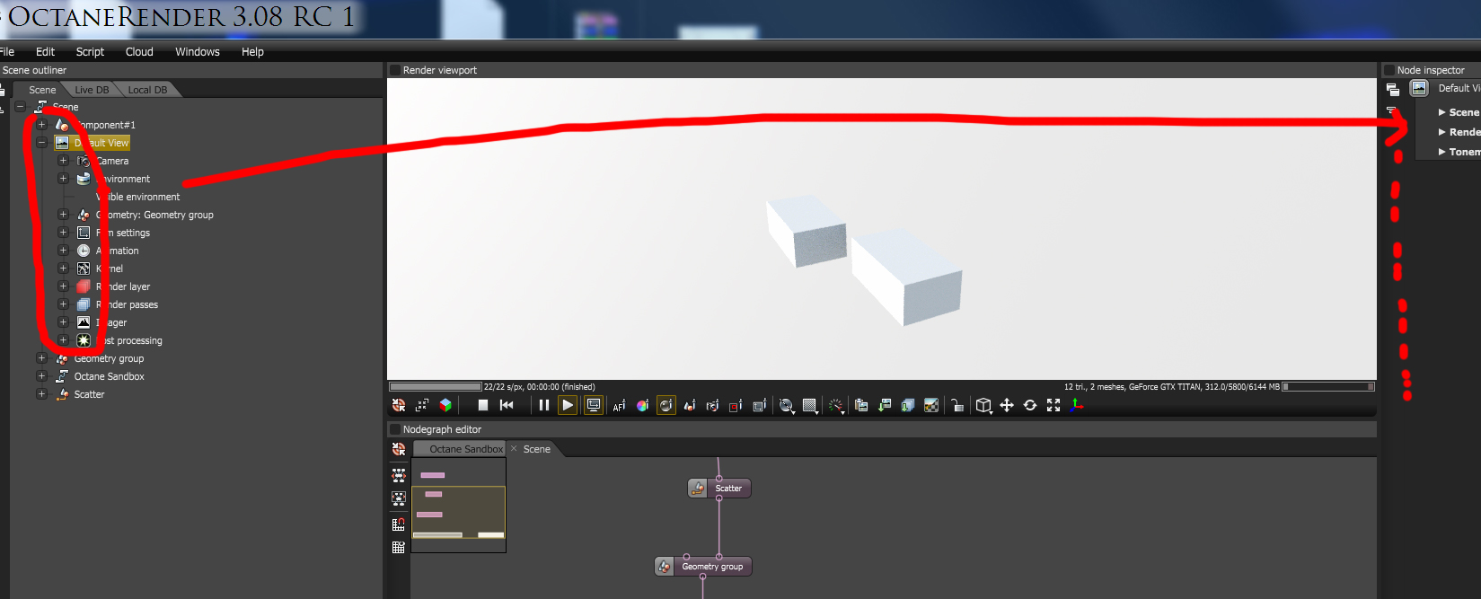

Just an idea
Is it possible to add a checkbox in the scene outliner that, when checked hides all other folders than the Default View?

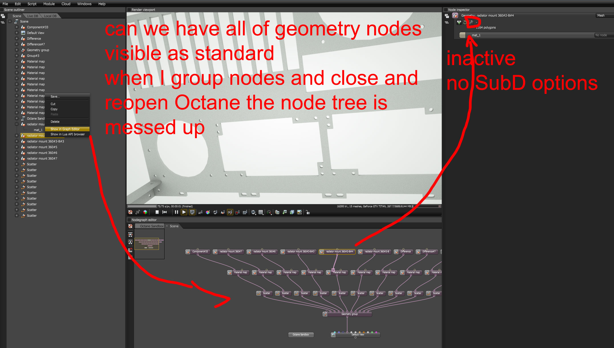

Guys,
1. We need obj geometry nodes with their settings - same as in the standalone
2. We need settings icons on the right - same as in the standalone
I wrote about it 1-2 years ago and nothing was done in this direction - PLEASE.

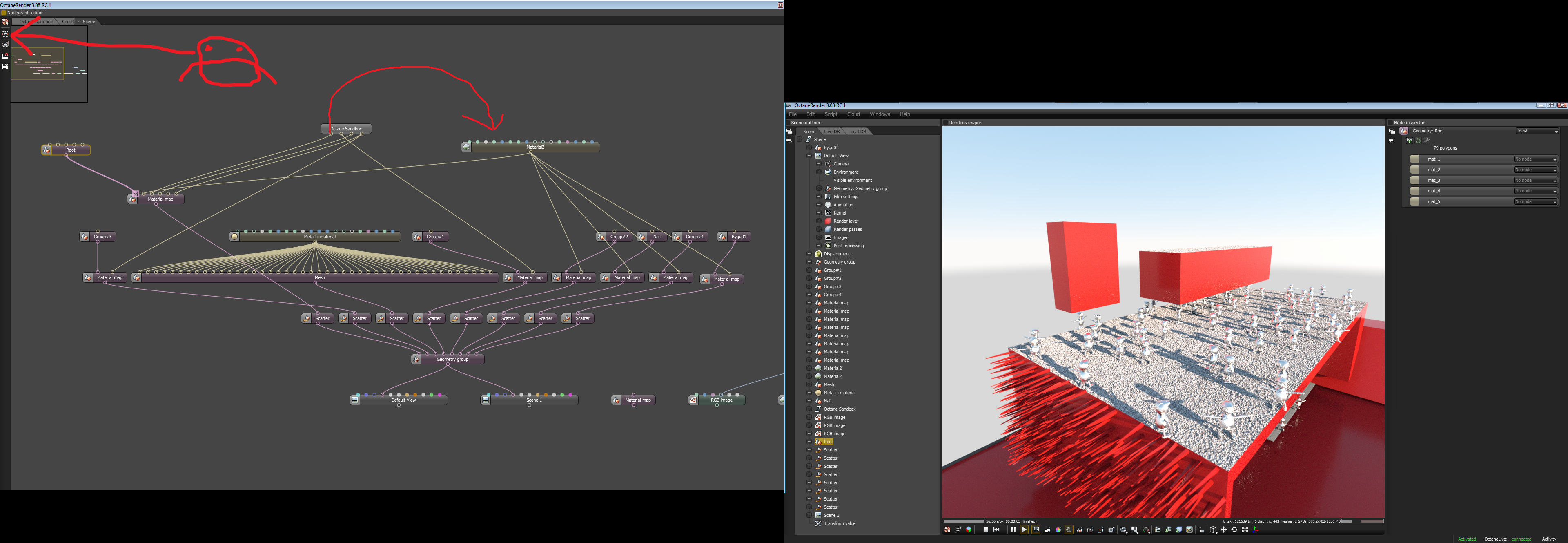

Materials lousing link to Octane Sandbox all the time. And I have to use the "Rearrange....button" konstantly.
This make SU plugin impossible to use!!!
Back to not using materials > see Clay mode with glass/specular.......
PS: No crashes yet ;)

If I pause the plug-in, user interface (I use dual screen setup) and Rendertarget> Sun settings, Imager etc. are resetted.
