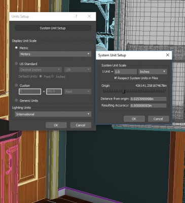

Okay thanks. Me renders really look good and clients never complain but I have a hard time on good interiour and evening lighting adjusting artifical lights.
Any idea how I can solve the problem with huge 700m large buildings after changing the units?

..OK can we just confirm this and how do we set system units and working units to make sure were working in the right dimensions .. does that mean whatever max says 1cm its the same as 1 m.. you understand how this gets confusing - can we have a 100% foolproof reference

Hi guys,
It is important to note the distinction between System and Display units. Display units only affect how geometry is displayed in the viewports.
System units determine the actual scale of geometry.
https://knowledge.autodesk.com/support/ ... 2-htm.html
Rescale World Units Utility:
https://knowledge.autodesk.com/support/ ... 4-htm.html
Regards
Paride

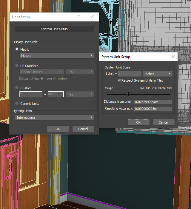

yes we know about system and display units. But it is ok to set 1 unit to inches, centimeters in system units besides the meters. I just want to make sure octane will treat it what ever it is set to.
