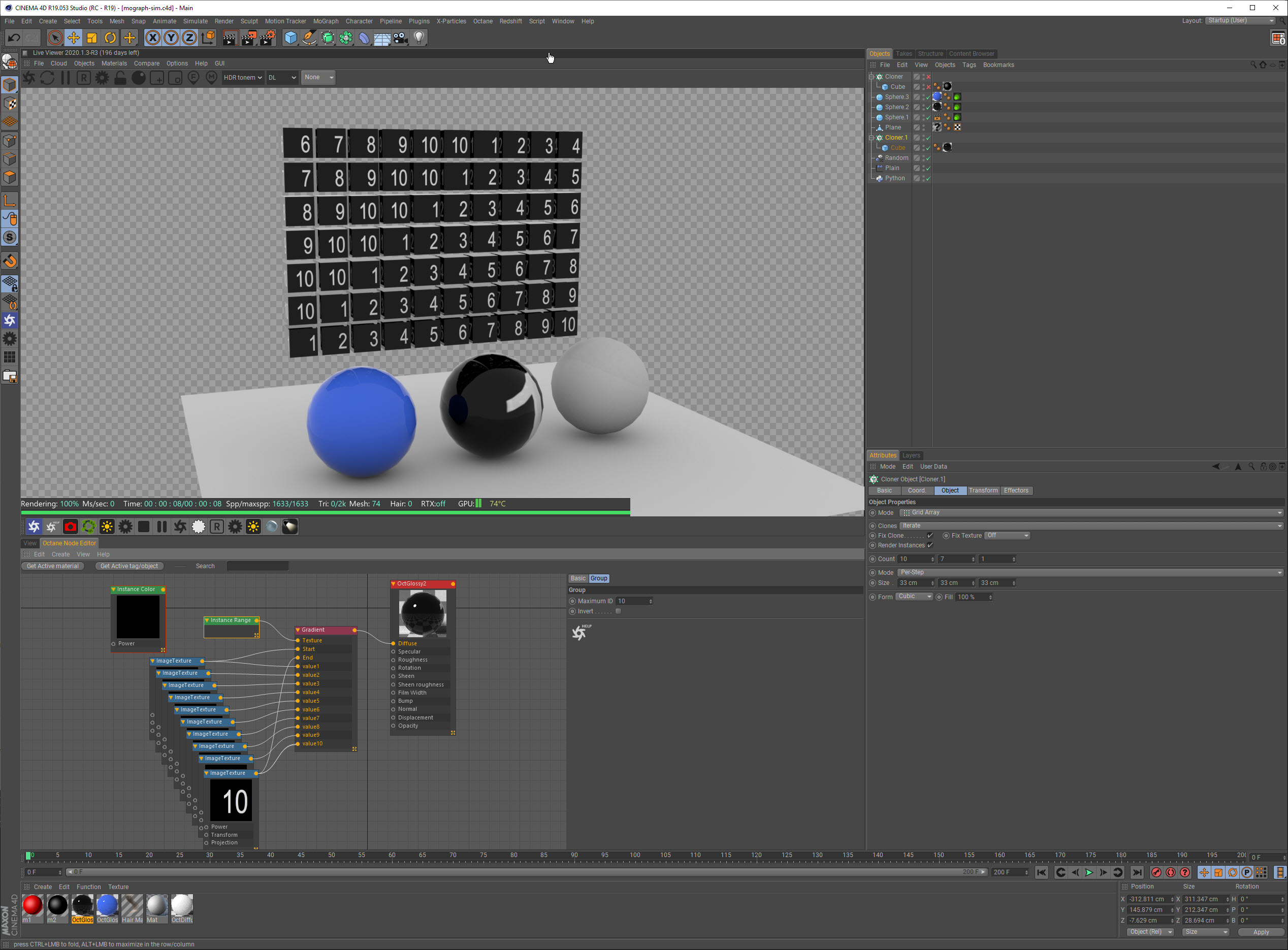

There's not a node as you wish! I've implemented mograph support a lot of months ago while we have limited possibilities. Here's another way to do what you wish.
mograph-sim.zip
(158.15 KiB) Downloaded 231 times
