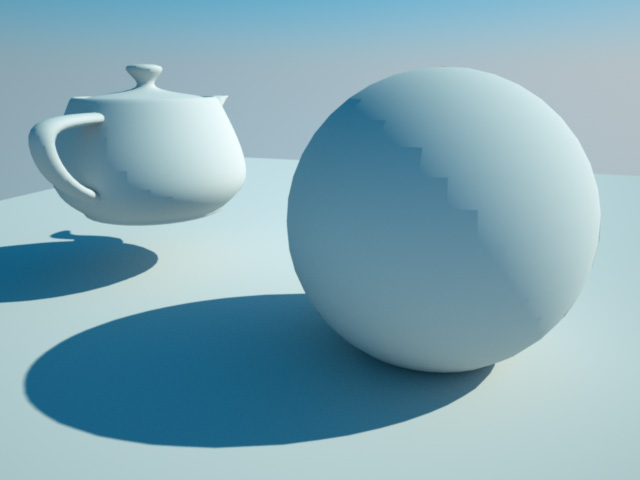

-Maybe I am wrong but I thought the terminator effect was mended.(See the image attached)
Terminator effect
Terminator effect
