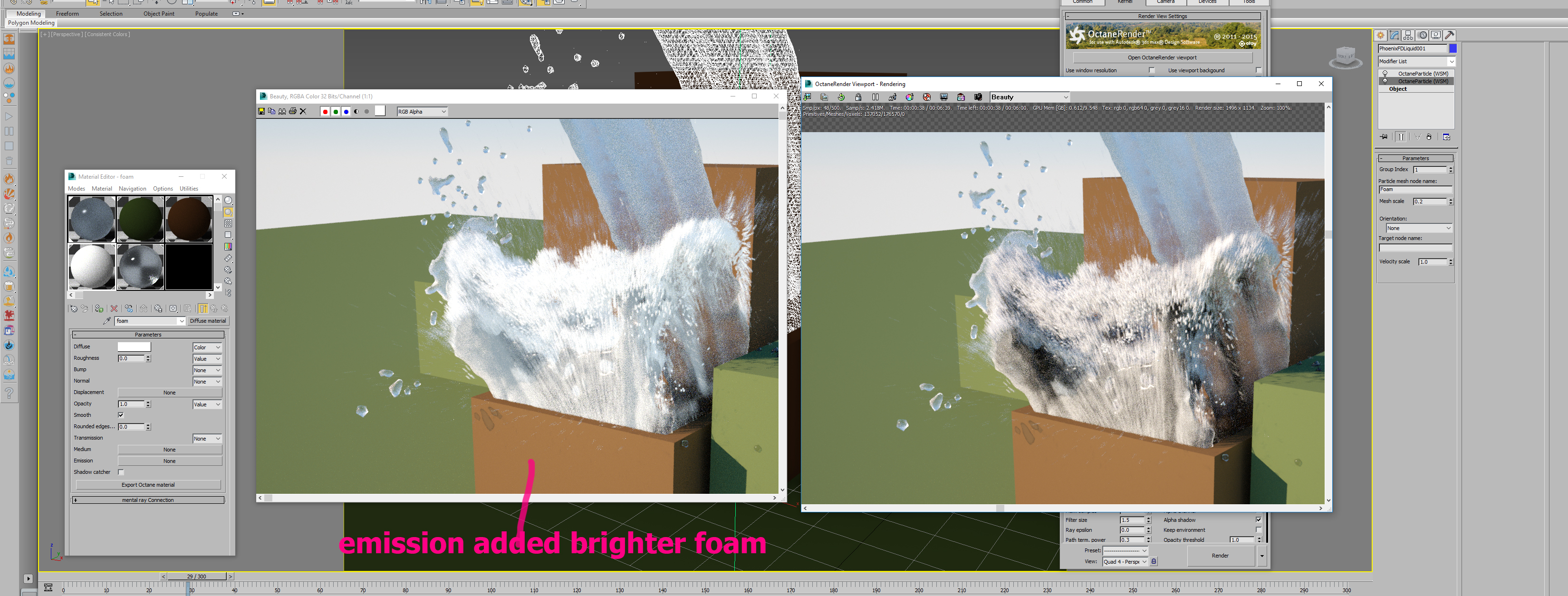

little advise on foam. Since using opacity or fall off is not an option (renderer just slows down VERY bad) use diffuse, 0.2 size foam particles in mesh scale modifier, and add emission of power 1 or less (disable cast light) so you will not get black shadows in foam since it is not transparent. maybe for small stuff like beer it is ok to use real falloff but large scale foam using transparent foam is impossible,

Here is the video. By the way with increase of foam loading time increases A LOT. It takes 8 seconds to render and over a minute to load all the foam. is foam set up as instance? Anyway way to speed it up? rendering went from 2-3 seconds per frame to over a minute when foam particles went up because of the count
Foam objects a very low poly spheres by the way.

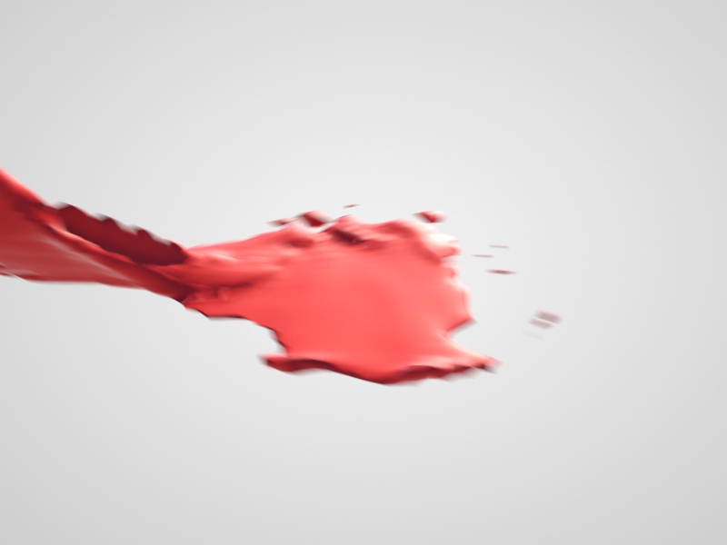

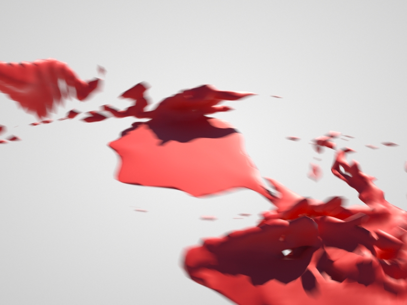

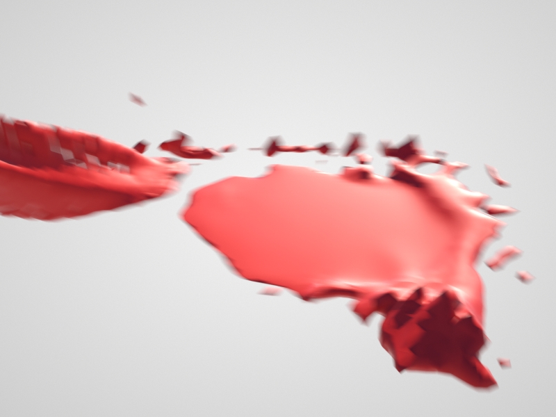

I just downloaded the demo for Pheonix and I'm wondering how to get motion blur to work with liquid?
My understanding is that octane doesnt support motion blur of changing topology and we have to export a velocity pass instead. Is this still correct and if so how is it done with pheonix? I can't seem to get the motion vector channel in octane to show anything but grey

HI darkline,
You should activate motion blur in rendering setting and in Octane object propierties (or vertex motion blur).
Regards
paride
Regards
paride
darkline wrote:Hi
no liquid does not work. Only foam particles and splashes will have mb

Hi Paride,
That looks great but can you please take us through a step by step as I'm not getting the same results as you. I have enabled motion blur in render settings, object and vertex motion blur on the Phoenix Liquid, and Velocity is ticked in the output of the liquid. What else do I need to do?
EDIT :
Ok so it seems you have to close the octane window and re-open it for motion blur to take effect. I think there is a bug in that if you frame advance on the max timeline motion blur disappears again. Motion blur only shows on the initial frame when you close/open the octane window, after that no motion blur is visible as you scrub animation (Max 2014)
EDIT :
