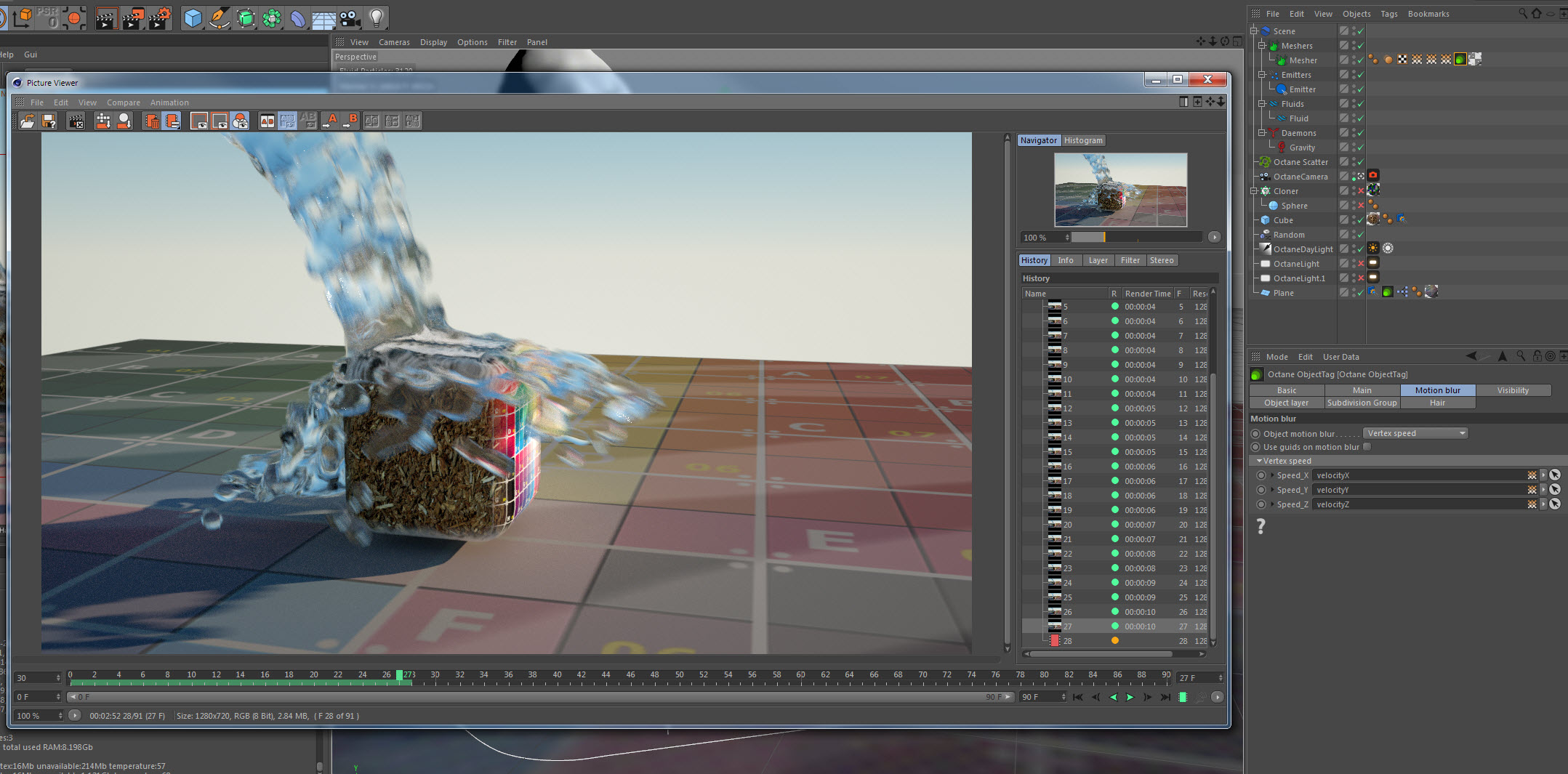

I've added a new motion blur option as some others does. Vertex speeds or velocities. It's working well on RealFlow plugin right now. Even with Live Viewer. See image!

I've updated to WIP-3 for regular builds. New motion blur options is available for testing. Enjoy it!

WoW New motion blur options.... :P Thanks...
