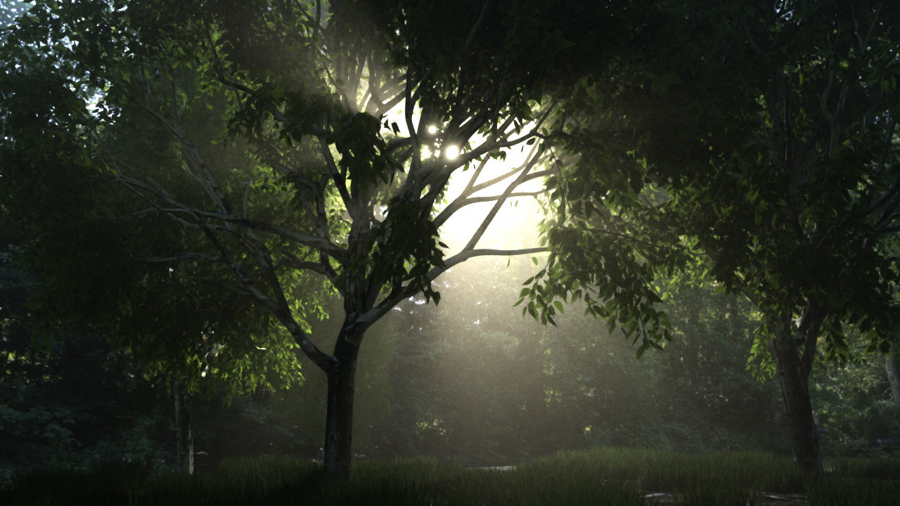

Here's properly cooked fog/mist.. Details in the foreground are very much visible. It's a choice in post work how much you want it. In a good photo there's little bit of absolute black and little bit of absolute white.

Well, this is not easy. Taking great pictures, with real camera isn't easy. When you see a commercial in a TV, the more easy it looks, more effort has been put into it. To make something look cool and easy, is the sign of serious skill. For example Slash makes guitar playing look so easy and effortless. There's a trick how he does that, and that takes some serious practice.
Instead of looking what I did, I recommend you get into Octane and into photography. Then you are able to recreate any mood / image you wish.
So, with the scene Juanjo posted, just fiddle with the settings. I have mentioned already all what I did, but in this image I also fiddled with white balance setting to get close to same color tone than in your reference image..

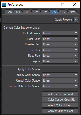

Remember to check that your LW color space (from LW Layout properties) is set to "linear".
