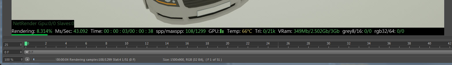

I've uploaded a new build with some improvements about gpu usage/temperature display and some alghoritm to avoid the overtheating of gpus in animation renders. These are some images to show that.

aoktar wrote:I've uploaded a new build with some improvements about gpu usage/temperature display and some alghoritm to avoid the overtheating of gpus in animation renders. These are some images to show that.
nice!

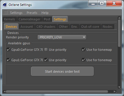

Question to device order test: in my case it seems to kill C4D - it's running endless with spinning wheel. How long should the test run if you have 4 Gpus?
Cheers
Ron
not more than one minute. But try to render a scene in LV at maxsamples high to be sure that will not stop before test. And try again to run test.
What's your C4D version and OS?

I did run a scene that renders > 5 min. Will try again.
C4D version R18.020
OS: Win 10 64bit
Note: the GPU temp and activity is shown on LV and PV after restarting C4D
