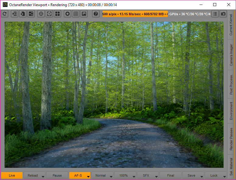

Thanks Paul :D :D :D :) ! It is working. For the first time able to load scene with pre-built Ultra Scatter instances :D ! Now can start to render more complex scenes and starting creating scenes using the UltraScatter and see how it goes. Thanks again for the fast turn around.
Just a sample scene loading perfectly now.
