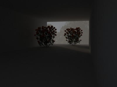

Hello everyone!
Today i tried 3.0 for the first time! went straight to the new displacement and noticed that now zbrush maps are working GREAT! Thank you very much. Also motion blur now works on displacement meshes.
However, for environment is not working for me. Have a look and let me know if i'm doing something wrong and hopefully more ppl can be enlightened too.
Tests were done in octane 3.2.1, in C4D r16 (.50)
I created this simple scene to test it:
this started odd, on a very simple scene i got these fireflies, where could they possibly coming from? material? they are just glossies...
Ok, so, now let's get some fog in! i added a medium to the octane daylight sistem and then i got this:
Definitelly the fog factor kicks in, but it's just scattering... where are the godrays? this looks like a cirscunstance where they would show up. if i crank the values the scene just washes out and don't get to see the effect.

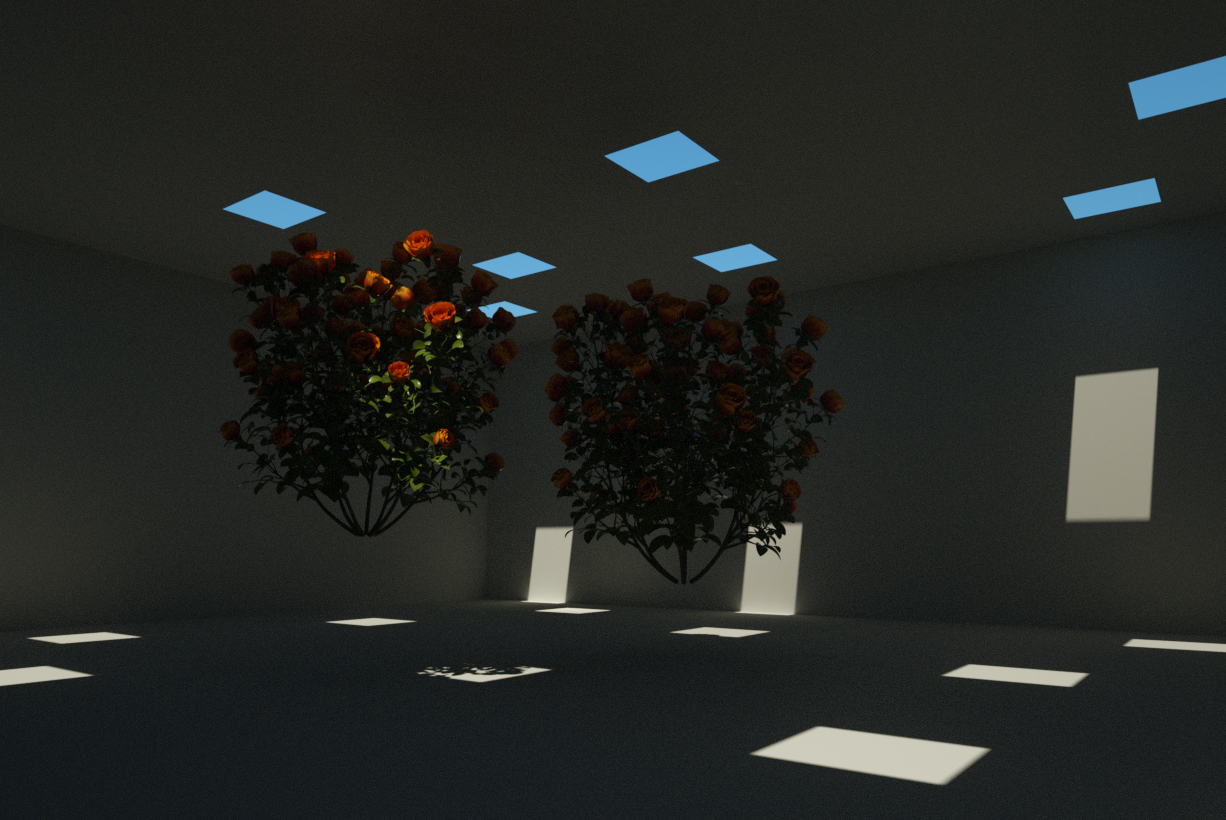

Then i tried it with hdr environment(maybe the daylightsistem got messed up?), and i got this:
Some problem, no projected lines in the "dust"

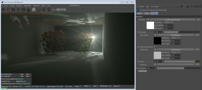

Posts: 10632
Hi Raf,
I have created a new black environment node with medium, reduced the light dimensions, moved it a bit behind the roses, and here is the result:
scene issue godrays_0001.7z
(4.04 MiB) Downloaded 625 times
The Phase has a great impact with god rays ;)
ciao beppe

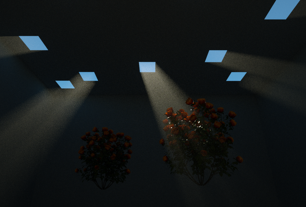

Hello friend! thank you for your help.
so, now i see, it looks like you need some peculiar settings to make them apear.

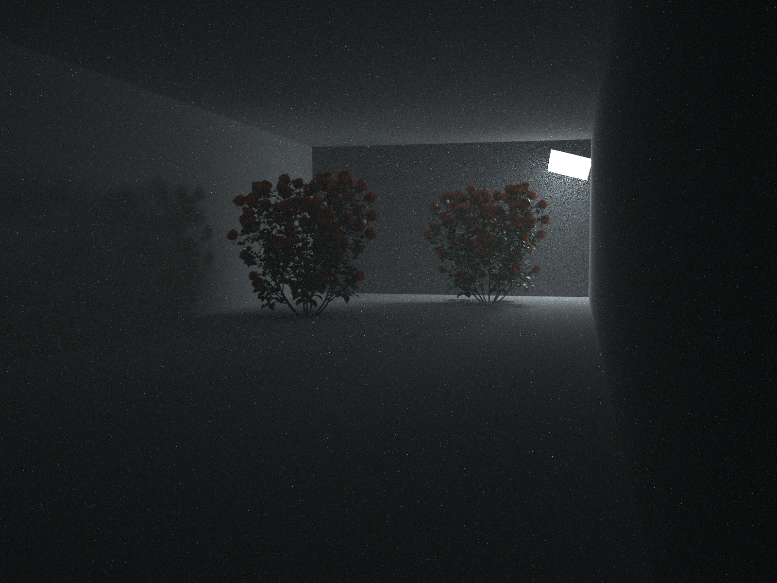

Tha's funny, it looks like it's only showing up when the light travels towards the camera.
As soon as light is traveling in the opposite direction form camera, you can't see any fog animore.
Also Phase(fron scattering/backscattering right?) plays a big one in this, so it makes light frontscatter towards the direction it is going to.
Thank you for clarifying! :)
