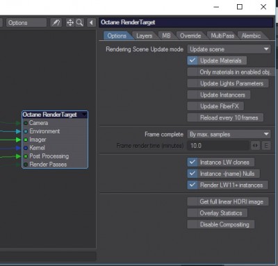

juanjgon
Posts: 8867
Location: Spain
panphoto wrote:Hi Juanjo,
I've hit problem during sequence rendering with the envelope not updating on Octane Falloff Texture. So for each frame I have to go back to Render Globals, progress the frame number manually and re-save RGB Files to get it to update. David
Are you rendering in "Update scene" mode? While rendering in this mode remember that you must enable the "Update materials" option if you have animated parameters in the materials.
-Juanjo
panphoto
Posts: 71
Joined: Fri Mar 22, 2013 1:12 pm
Oh! I don't know about these modes. Please can you direct me to the 'buttons' I need to press. Thanks.
David
juanjgon
Posts: 8867
Location: Spain
These options are in the render target root node options panel, in the "Options" tab.
-Juanjo
panphoto
Posts: 71
Hi Juanjo, No, update wasn't checked - to be honest I didn't know about this menu. Many thanks,
David
