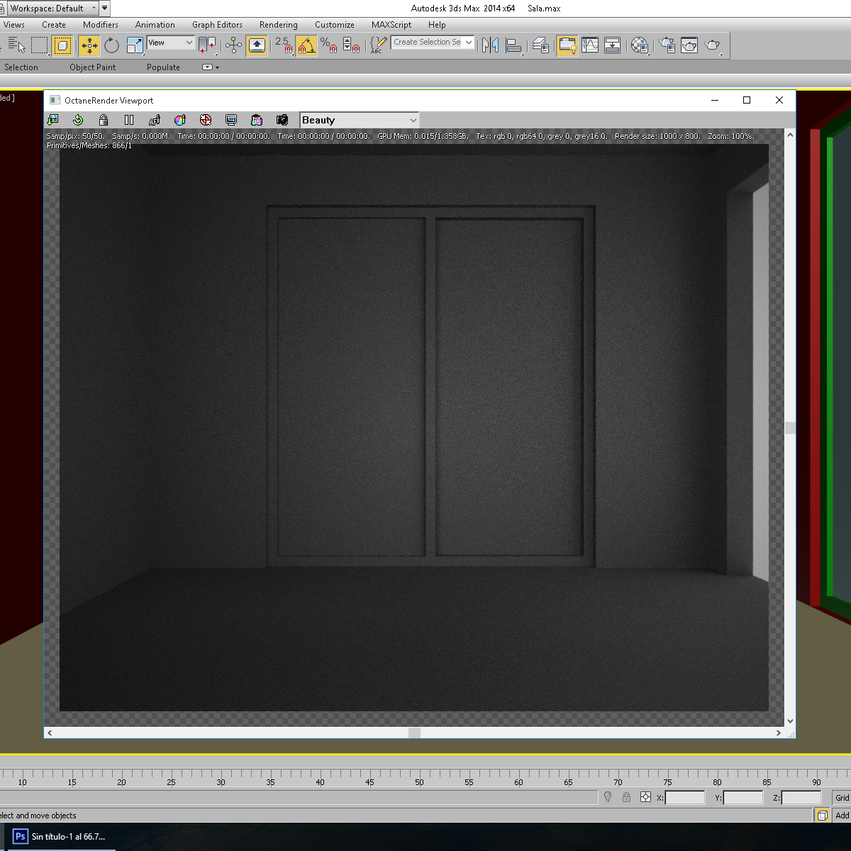

NO WORK Use thone mapping !!!!! don't even get this version.... while it is possible to work 2.15
