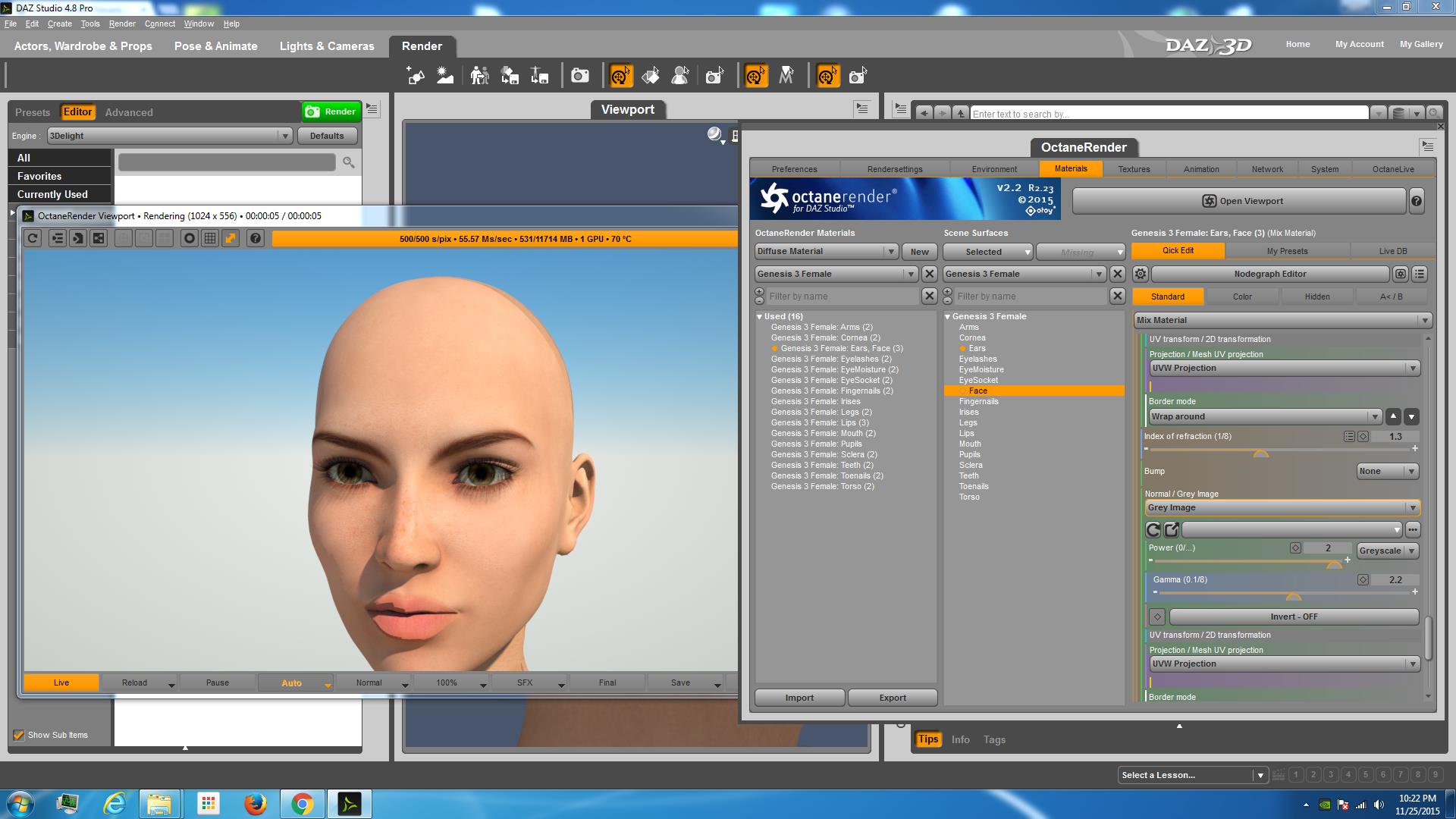

Guys, so we can agree that as a simple start, Iray is 'fixed' by changing Opacity from Greyscale to Grey Image, right?
Now, with regard to SSS mats, which would be the better 'universal' fix-rule for SSS mats - Normals power at 2 causes Toon textures, so we can:
1) Set power from 2 to 0
2) Turn off Normals node
3) Set RGB Image in Normals node to Grey Image, Greyscale, (anything other than RGB Image)
Here is me setting RGB Image to Grey Image (which is what allows us to fix the Iray issue). Maybe the breakdown in conversion across the board (in both Iray and SSS mats) stems from not translating to a Grey Image?
A G3F SSS mat workaround - set Normals Node dropdown from RGB Image to Grey Image, you don't have to delete node or reduce power from 2 to 0
So my layman's logic:
If Iray Opacity = Greyscale, then set Opacity to Grey Image + Load Grey Image
If SSS Normal value >1,
Seems option 3 is most consistent with the Iray choice, whatest thou thinkest...

Notiusweb wrote:So my layman's logic:
This isn't limited to Iray, and is covered by what I have above. The code box is limited in displayed size, unfortunately, so it extends down a fair bit. I could rewrite it less code-looking if that would make it easier to read, I'm taking a Python class, and it's what popped into my head when 'logical if-then' got mentioned. I wasn't attempting to make it harder for people to read :oops:
Notiusweb wrote: If SSS Normal value >1,
This seems like three options to do the same thing, which is disable normal map. setting it to zero, turning it off, and disabling the image input itself are all doing the same thing. If there is a displacement map present, it would never be loaded just following what I came up with before as a rough idea, likewise, it specifically dropped the strength of normal maps down to 1 if there was no displacement and a normal map was present and set >1, which should eliminate the toon texture issue regardless. Though normal strength may still be too high, at least it should be visually apparent that it's set too high.
I understand and am with you 100%, just was trying to confirm with anyone else that the Iray thing made sense :)
Would we code it to drop power to '0', it looks like you would be saying if > 1, set power to 1....but at 1 it still has the toon textures, like, we have to bring it all the way down to 0, so wouldn't we want to say if >1 drop to '0'....just checking. If what you have already eliminated any need to drop to '0', then of course that is good.
Since we may already have the coding with you supplying it, I'd say lets move this forward for Paul's review!
Lets get these new Iray and SSS mats rendering automatically!!!
@Paul - I think Spectralis is referring to the Iray and new SSS textures, which are being released for both G3 and G2. So, some newer G2 mats convert incorrectly too. It's not the G2 base, it's these newer Iray and SSS mats for G2. It's all the same issues as with the G3...it's the mats.
