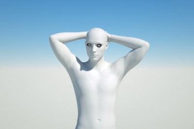

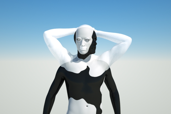

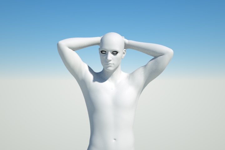

Thank you. Another issue I just tested, that I think has been around for a while is, geometry shells do not update when a figure is reposed, moved, etc. The only way to make them update is to force rebuild the scene. This is problematic for animations as well.
When first applied
When pose changes
