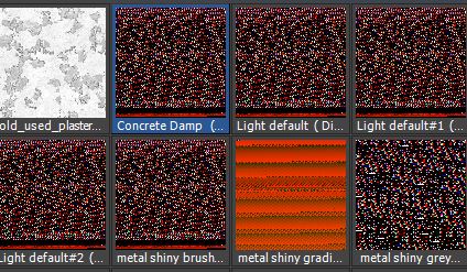

acc24ex
Posts: 1481
Joined: Fri Mar 19, 2010 10:58 pm
Location: Croatia
so this is how my library material always tends to show up - I can clear it if I change renderer to standard and then back
- I thought it had issue with corona render, which I removed, still shows up
- anyone with similar issues?
max 2016

acc24ex wrote:so this is how my library material always tends to show up - I can clear it if I change renderer to standard and then back
I dont have that..
is this problem same with the old material Editor?
And which max version does this take place.
Does other max versions act the same way?

acc24ex
Posts: 1481
Location: Croatia
.. oh yeah, I edited it - max 2016 .. don't have this kernel on 2015 so didnt test
- and it happenes in slate material editor sometimes.. really though it was because of corona, maybe there's something else with my max - so if anyone runs into this might as well be a bug..
