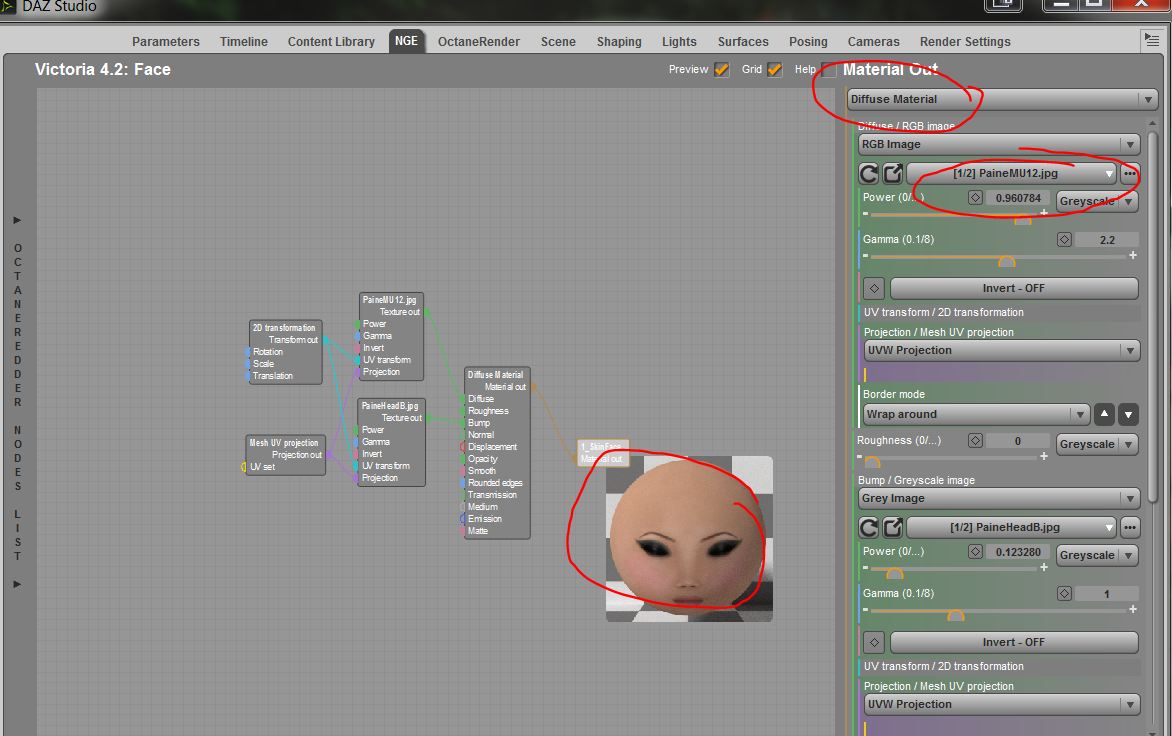

Anyone else having issues when switch Materials from Diffuse to Mix ?
For me the NGE throws all texture settings away. Need to change it back from RBG Colour to Image and select the texture for fist and second material.
In older Version the Diffuse Material stays as normal as it should.
Here is an example of a V4 Face :

Hubby72 wrote:Anyone else having issues when switch Materials from Diffuse to Mix ?
I never did it this way in the past. I would make a mix material and drag the diffuse to it. Changing a nodes type can be tricky.
