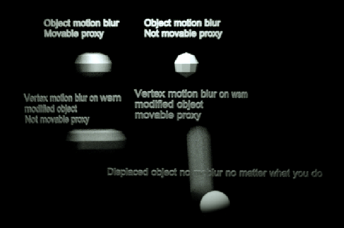

So I have set up a file to show the different motion blur bugs.
Here it comes:
Best
//Daniel

Thank you for report, I'm just checking your scene...dawe wrote:So I have set up a file to show the different motion blur bugs.
So, correct me if I'm wrong: you mean the issue is there is no object motion blur for the objects that are not movable proxies? If yes - then it's not an issue... It's the specific of how the geometry is loaded into the Octane engine.
All not movable proxy objects are collapsed into one big global mesh during the scene translation. This has two sideeffects:
1. The scene is rendered much faster by Octane engine than the scene having big amount of different meshes.
2. This global mesh - is just one big common mesh in the world space. It can't have separate transformation matices for its "subobjects" (as it does not have any subobjects). But what is the "object motion blur"? It uses object's transformation matrix changed from frame to frame to render the blurred image of the object changed by this matrix from frame to frame. But your "not proxy" object is not the separate object anymore after loading into Octane engine - it's just one little part of one big global mesh. So, you can't have the "object motion blur" for such an object - as it just does not have its own transformation matrix, it's just not the "object" anymore inside Octane engine...
So, if you need the object motion blur - you need the object for that. That is - you need it as "movable proxy" in 3ds Max plugin terminology.
