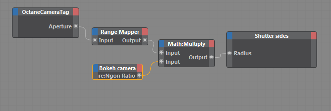

I was doing various tests and I found in some cases that when I increase camera aperture the image goes darker. But if I increase the radius of the ngon the image goes bright again. I found in my personal tests that the ratio between aperture and ngon radius is 1:1 so you can maintain the same values of the image.
I'm working right now on a animation project and I using the custom bokeh trick, the thing is I'm animating the aperture size along the camera path, so I did this simple xpresso setup that maybe you find interesting:
The ngon radius is animated automaticaly depending on aperture value, on a ratio of 1:1, you also can change the ratio on the camera user data to 1:2 or whatever you want.
The file is the same that martincarlson upload, so you should save on "custom shutter" folder to link the texture.
