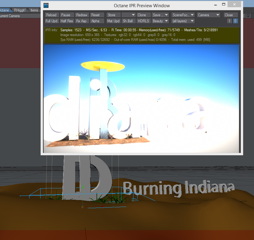

Having the following issue:
Resized and repositioned an object but a ghost is being left and my ground is disappearing. I do have Octane materials on them.
Using API build 2.21.
As the pic shows, ground is gone and the text is being picked up as having been transformed but the solid ghost is messing up the shot.
Edit: seems to be a confusion of layers. As I was preparing this note, I tried to move the ground. The Indiana moved: the ground and Indiana have somehow been switched.
Edit2: Since I did that, went back in and renamed the layers. Octane played it right.
Using 2015.2. Something is different. But I got it where I need it. Thanks for reading.

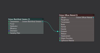

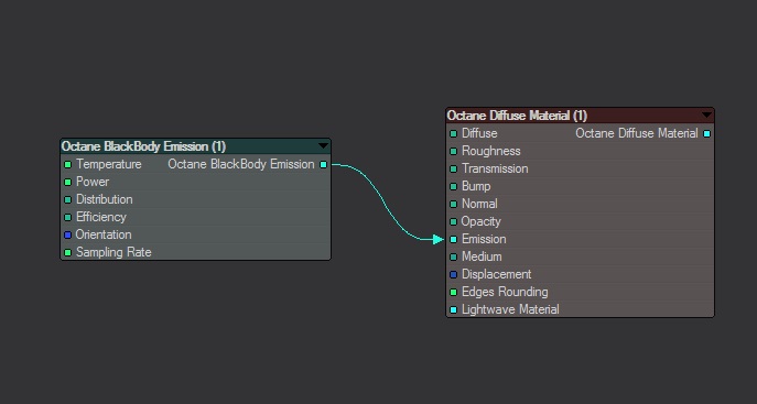

I don't seem to have any emission inputs on any of the three materials in 2015.2.
How about you?
i7-4770K, 32gb ram, windows 8.1, GTX Titan and gt 620 for display
juanjgon
Posts: 8867
Location: Spain
I have the emission input in the diffuse material as always. Don't you have this input?
-Juanjo
UnCommonGrafx
Posts: 199
Joined: Wed Mar 13, 2013 9:14 pm
A late night. Yes, on the diffuse, I have the pin.
Eyes a little clearer now.
Thanks.
