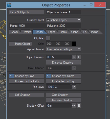

Amazing ... when you enable a Modeler guides object in the FiberFX panel, Layout changes the guides object "unseen by camera" flag and set it to enabled. You need to disable it, because with this flag enabled, all the hair system is hide in Octane ;)
