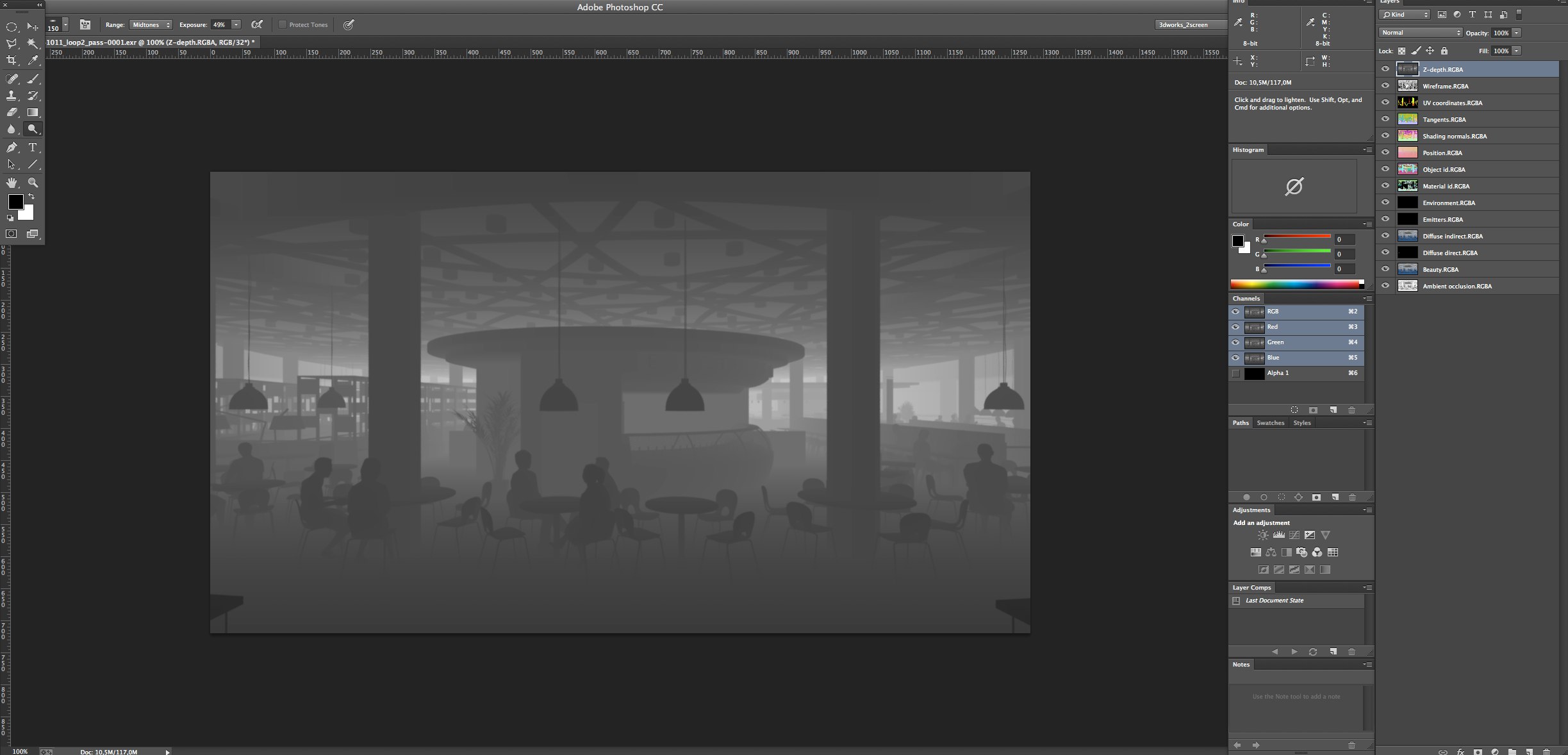

Builtdown wrote:It´s a shame if Photoshop can´t open EXR-files properly because I think it is the most used program.
Another weird problem :
I installed the new Beta today. I was testing the new render passes with an old scene. I started rendering normally with F9 as before. Everything looks ok in render preview window. But when the image is finished, the final image is warped. See attached. What the heck?

juanjgon wrote:
Builtdown wrote:Thanks! Color correction node will be very useful.
I´m testing the render passes node. I have set the node and save file, selected the passes and it seems to render properly. It saves a 46mb exr-file. But when I open it in Photoshop CS5 it only gives me one layer that is completely black. I wounder what is the problem?
I think that Photoshop has problems with this kind of files. I am testing the multilayer EXR files here with Fusion and all works fine. Is there anyone that can load the EXR files in PS without problems?
-Juanjo
PS does not natively support multi layer EXR files. but there is this proexr plugin at
http://www.fnordware.com - which does an excellent job!
EDIT: btw it would be nice to see DWA compression included! see this
http://fnordware.blogspot.de/2014/08/dw ... xr-22.html
