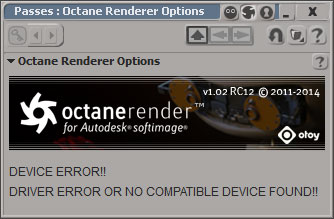

I retried opening the "Render Settings" now and it opens correctly (no empty). I can't really tell what made it to work. But one thing that "I think" has changed is that I installed latest nvidia driver. You see the moment I tried and posted before, it was after a very newly formated system. So I suspect that with the dirvers I had previously there was no CUDA support and it COULD be the issue, but again, I am not sure.
So I was able to activate my account now.
Problem is that like the other user here, the Preview window is empty. The progress bar (samples per pixel) also doesn't move.
Of course I tried reopening the window, scrubing the time (don't know if that's still relevant). C++ redistributable is installed.
RC 11 works fine though. One slight thing that I noticed (maybe it's totaly irelevant), is that in the "OctaneLive Account" tab at the botton, the ID in RC 12 is not shown where it does in RC 11 (with an activated account)
I think youre right with the driver. The PPG uses information from the Octane API. Maybe i can implement a driver check.

After some testing, i have changed the initializing process where now the display adapter is checked on compatibility and if he uses the right driver version.
Should also work with multiple different adapters/drivers. Only one is needed to pass the check.
This can happens when you use a mixed GeForce/Quadro/Tesla rig.
The correct output looks like:
' INFO : Initialize OctaneRender® 1.0213 RC for Autodesk® Softimage®.
' INFO : Check Adapter: NVIDIA GeForce GTX 670
' INFO : Check Driver: v.340.52...done.
' INFO : 1 CUDA compatible Device found.
The error one:
' ERROR : Check Adapter: NVIDIA GeForce GTX 670
' ERROR : Check Driver: v.335.12...failed!!!
' ERROR : Driver version conflict, need version > 337.0!
Or:
' ERROR : No CUDA compatible Device found!
You will also get an info in the PPG:
