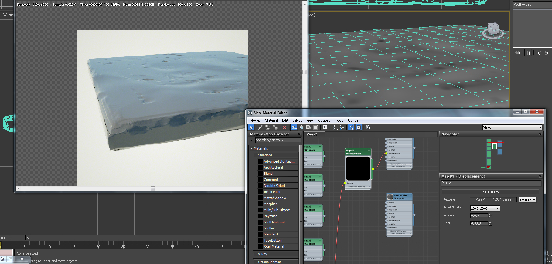

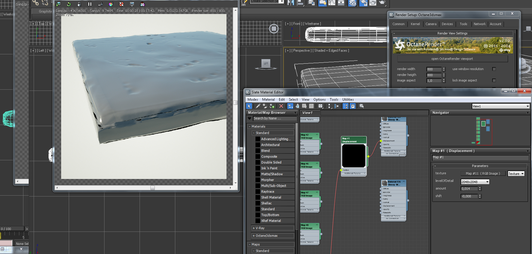

Savdep wrote:Hello Karba.
I have found one bug, but I don't know does anybody have this one too or doesn't.
So, displacement.
I set all settings of displacement and opened render viewport. It was working like was needed. Than I closed Octane render viewport, saved my scene, opened the viewport again, and have seen absolutely another result - a wrong result, more smooth and inflated. Settings of course was same.
(This bug is very noticeable when you use a low poly model and dips map from high poly model from sculpt program to add detalization thought disp map)
Could you tell me, when will you be able to fix it?
Thank you in advance.
Best.
Could you please post some renders here?
Savdep
Posts: 10
Joined: Fri Jun 29, 2012 1:22 pm
Karba wrote: Could you please post some renders here?
Yes, of course.
This is a tile. Look at these screens please.
One of them is right like high poly model:
gooddisp
gooddisp
The second is wrong.
wrongdisp
wrongdisp
Please, notice that settings and the map are same.
In additional I can say that I have had this case 2 times. After the first it normalized independently, but now I can not repeat the first result again.
If you don't mind, I will send you this scene in advance. Maybe you will need it to solve this issue.
