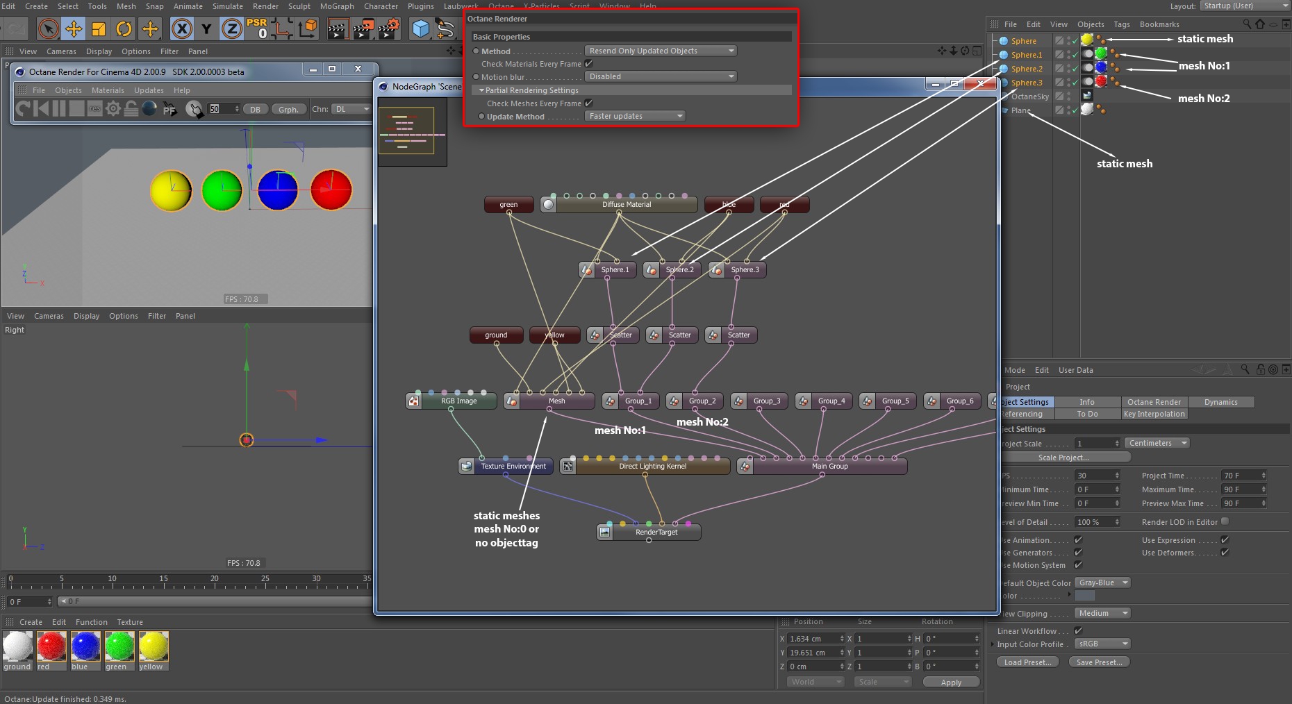

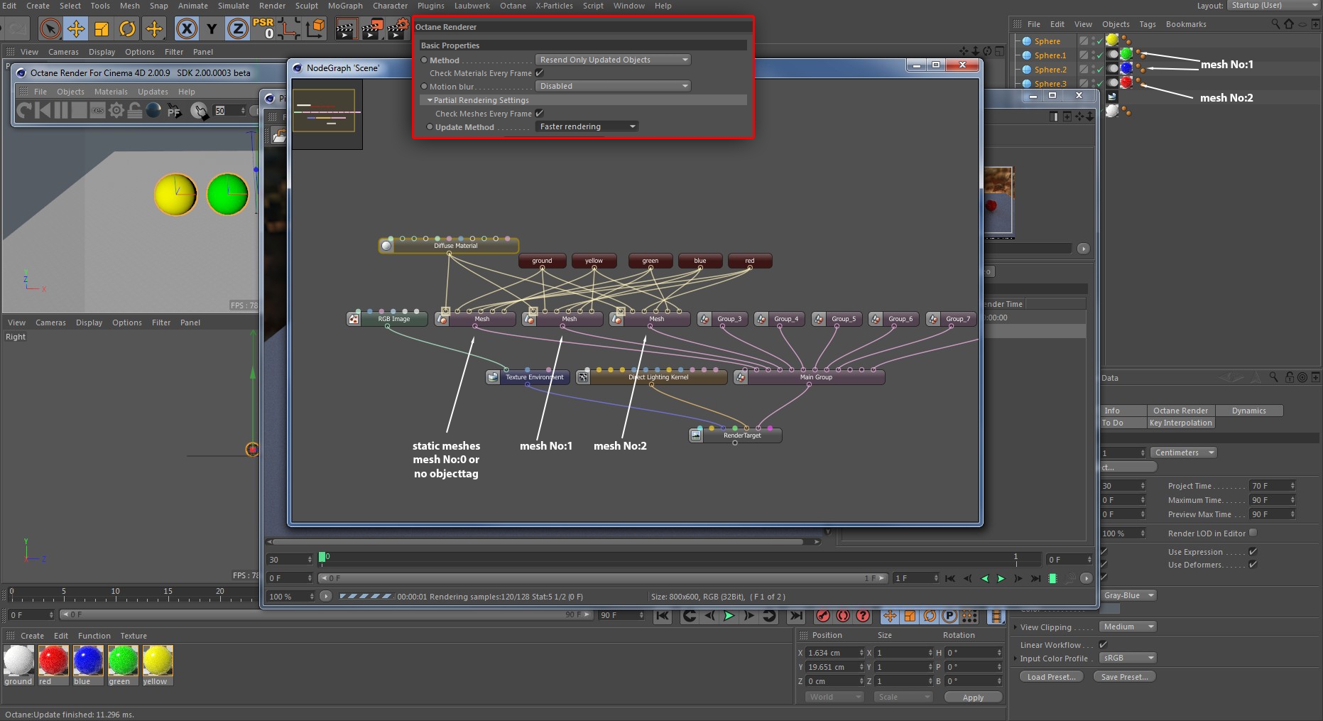

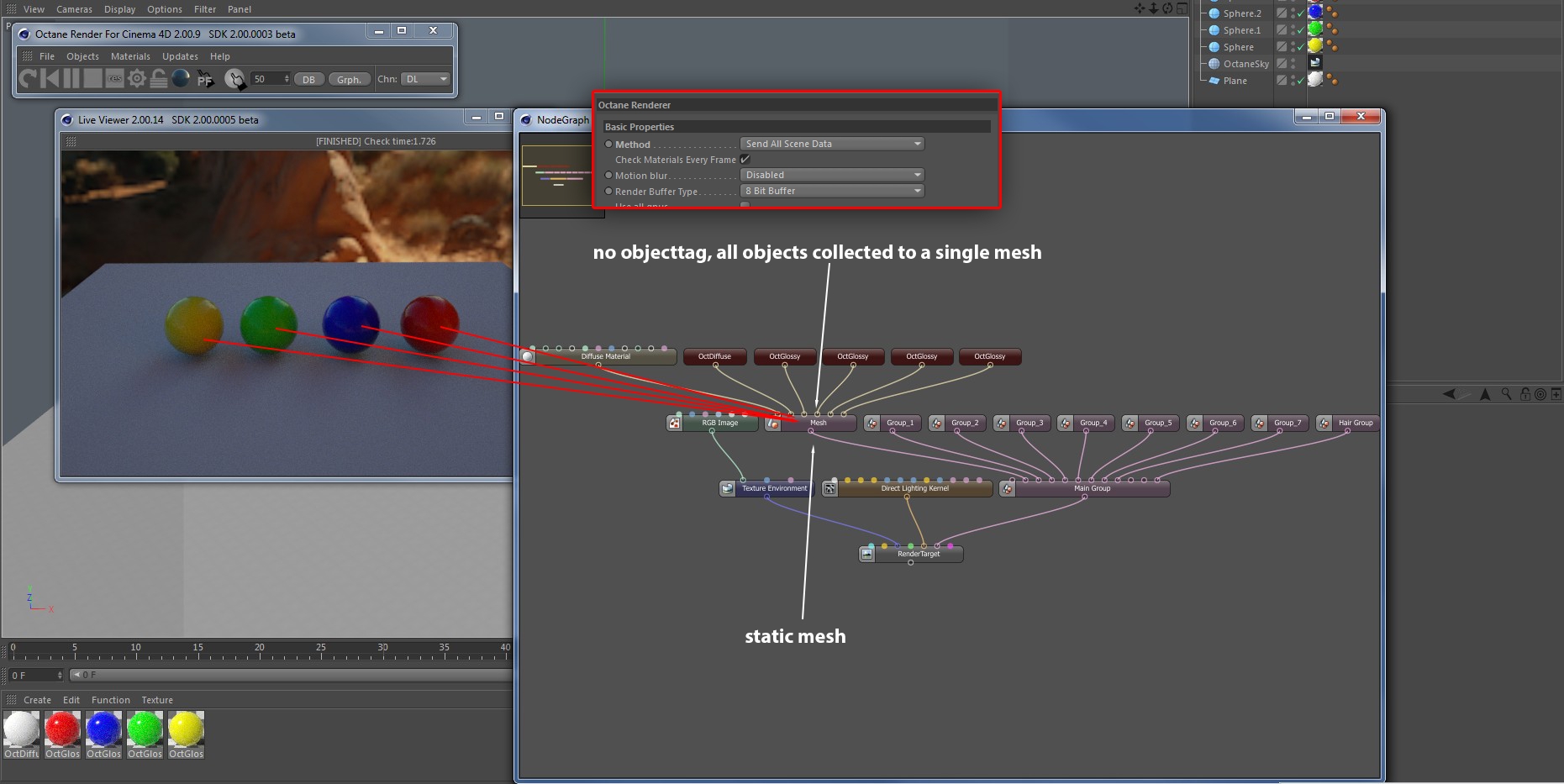

i don't understand your problem. Can you describe more?
I try to show differents on render settings and main concept of design of plugin, in pictures. check pls, and let's talk

I posted this to give some idea about structure differences. This may be helpfull to others.
Your problem is not normal, maybe a bug here. It shouldn't be directly related with this settings.
Can you give me a part of scene to test it?

thanks ahmet for the screenshots, now is more clear what happens behind that parameter ;)
basically with "faster update" only the PSR of the tagged object is updated by frame, while with "faster render" the tagged object is re-exported every frame, correct?
ciao beppe
Posts: 16068
Location: Türkiye
bepeg4d wrote:thanks ahmet for the screenshots, now is more clear what happens behind that parameter ;)
ciao beppe
Hi Beppe,
I'll put this diagram to manual. Yes, correct.
Faster updates, exports all objects to indivual octane meshes and connect with some transform and objectlayer(if necessary). This allows to me make some partial updates for only updated objects. This lowers the mesh compiling times. But decreases render speed on complex scenes. This is same with Interactive structure of LV. We have to use this method often for object motion blurs.
Faster rendering, collect all mesh group to one single mesh. As, meshno=0 goes to first, meshno=1 goes to second, etc...
This may be better on render speed. But we loose object transforms. Transform is needed for some texture mappings, motion blur. Also, we loose the advantage of updating of only one mesh. If any object is updated on meshno=1, we have to reexport all meshno=1.
