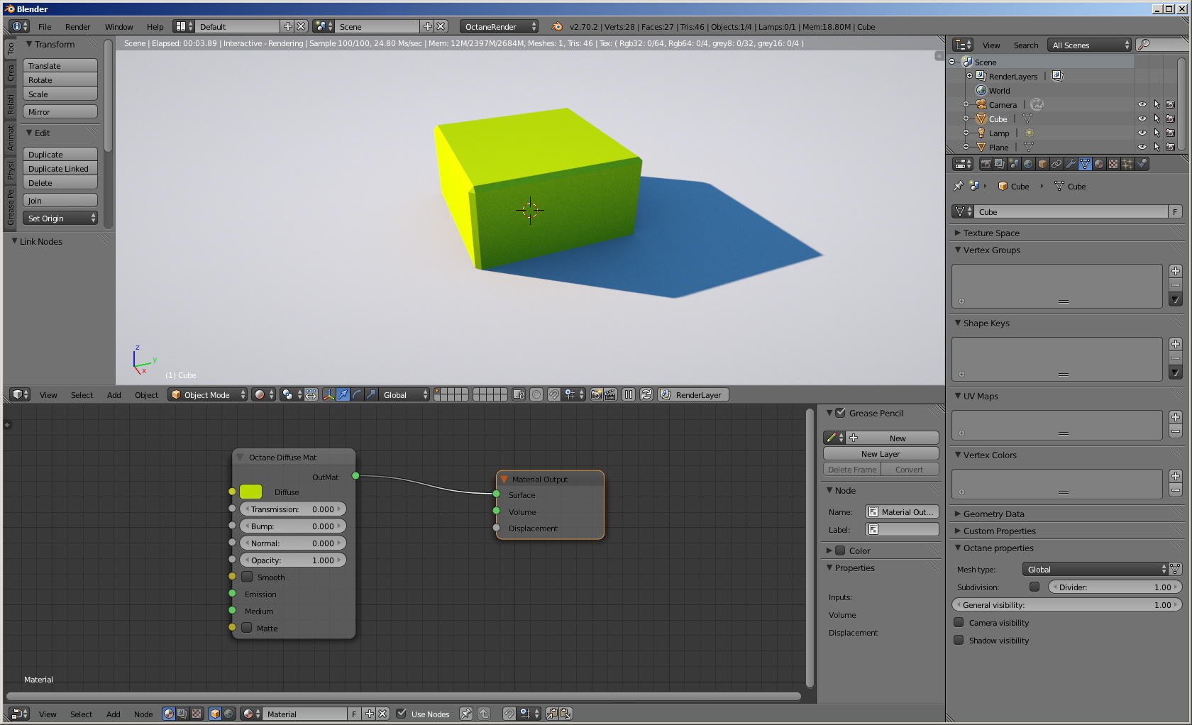

Hi,Alain wrote:Visibility seems not to work (shadow and cube should be invisible).
Did I miss something ?
Kind regards
Alain
You need to set your cube as "movable proxy". If as global, all the scene will be compiled as one geometry, so impossible to say "cube is not visible" because is the same global object. Need to restart the rendering to apply the new meshes compilation.
Matt
