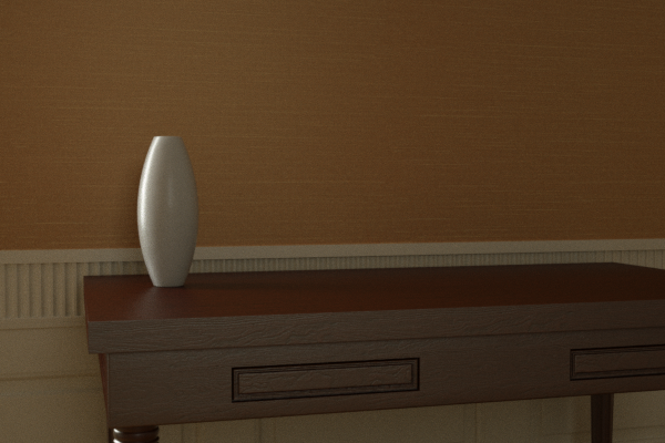

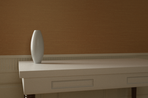

below is a test render with version 153_1_65 and here is the same scene with the new version 153_1_69 installed.
part of the object know does not have the texture applied.
This is still the same scene as the before nothing changed other than the install of the new version of the plugin.
The mesh has different material tags for the legs, apron and table top but they all use the same uv map.
Hi Keith - there was a change made to how texturemaps get picked up from the Shader Tree in 1.53.1.69. Is it possible that tabletop texturemap is below the Modo material in the Shader Tree? Does the tabletop render correctly in Modo? Would it be possible to send me that scene pls - then I can determine if it's a plugin error or not.
Paul
Hi Paul it is to do with the stacking of the layers. In modo it renders correctly. If I move the materials to the top of the stack it renders ok in Octane.
The table item is in an imported shaders group. If I move the the imported shaders group above any items loaded from the modo content it renders ok.
Do you have a private email I can send the scene to you?

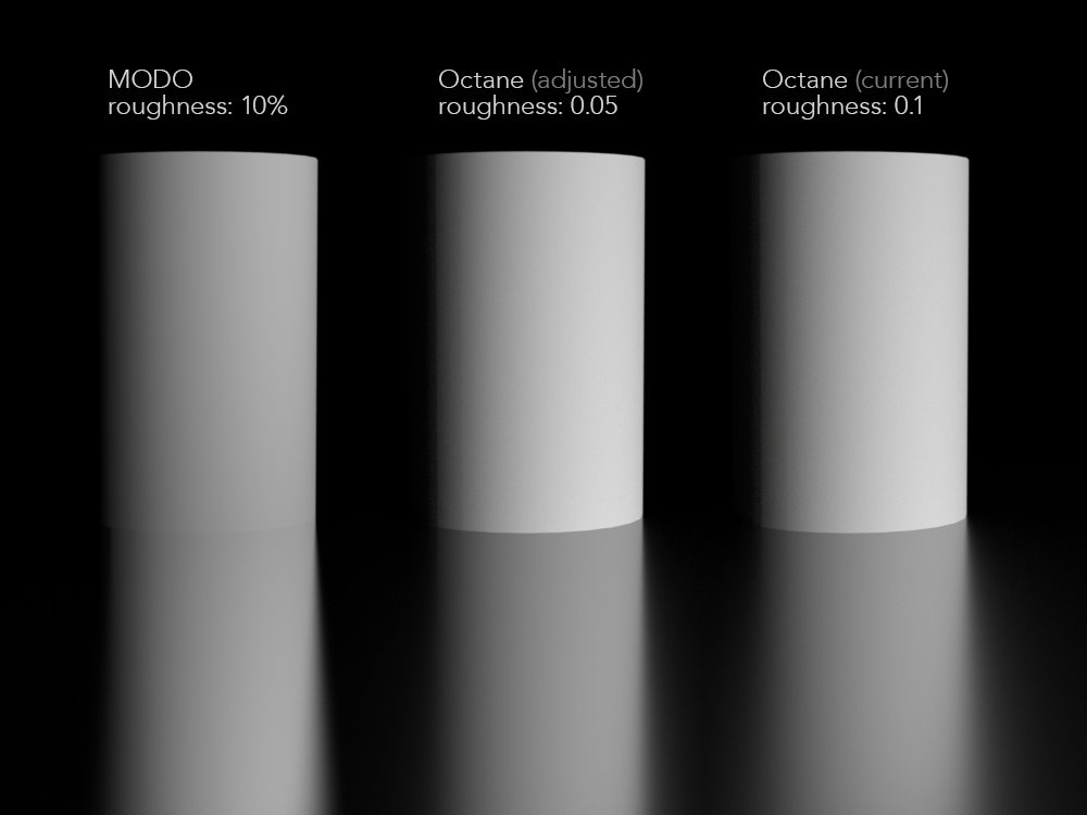

I've noticed that the roughness conversion is still off. Right now, Octane does a straight value transfer (10% = 0.10) for the roughness, but the effective range of roughness in Octane materials is higher than MODO. It's not exact, but cutting the current Octane value in half gives a more accurate result.
I agree - they are still not exactly matched. Even halved, looks too much to me. The Octane "roughness" amount if logarithmic, whereas I suspect the Modo roughness is linear. I will see what can be done.
