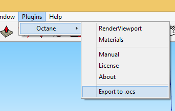

is it possible to export scene from SketchUp so it could be opened in Standalone? =)

glimpse wrote:hi, Fuzzy.
Glimpse,
You can use obj exporter and other plugins like TIG and mine

But if you are asking if the new sketchup plugin can create/export something like .ocs or .orbx that can be opened in standalone - this would be fantastic!

smicha wrote:But if you are asking if the new sketchup plugin can create/export something like .ocs or .orbx that can be opened in standalone - this would be fantastic!
That was what I had in mind =) I've tried doing this type of thing from 3dsmax (some scenes worked some not, anyway..not the point here). If SU couldn't handle some scene, but would allow exportin =) the problem would be solved as once You've reached the limmit simply jump into StandAlone (that personally I preffer to use) & finish what has been started elswhere(but I'm not sure if SU have this, that's why I'm asking =).
Yes indeed. But it will be exported preserving Sketchup component mapping, i.e. not as a single mesh but as a groups of objects.
If you want to export SU scene as a single mesh you'll have to explode all the geometry to a single mesh and export it to .ocs.
Export is very fast
glimpse
Posts: 3740
fuzzybro wrote: Yes indeed. But it will be exported preserving Sketchup component mapping, i.e. not as a single mesh but as a groups of objects.
Export is very fast
Export is very fast
This option its really great. You just need to be careful for now.
In SU if you need to export as .OCS just hit export and you are done, but you will have a many many many...nodes because of the way Octane handles the geometry that comes from SU(inside the pluggin)
So you can use the Bomb.rb to explode all before export.
http://www.smustard.com/script/Bomb
Be carefull with some things:
- if you have hidden geometry it explodes too. The best way is to use layers.
- If you are using proxys and scattered components put them on separated layer too and export it after. or they will explode.
Octane 4 SU uses components as scatter so if you have 1 component x 100 places , octane only loads 1 and scatter the rest :D ....don't explode it...or you will lose this.
The SU 32bits limitation is a pain...but fuzzy made a really great job optimizing the way geometry is imported to Octane (inside SU limitation), so this is the rice to pay for the 32bits problem, for now we just need to export all before we save as .OCS... For now its ok by me ;)
