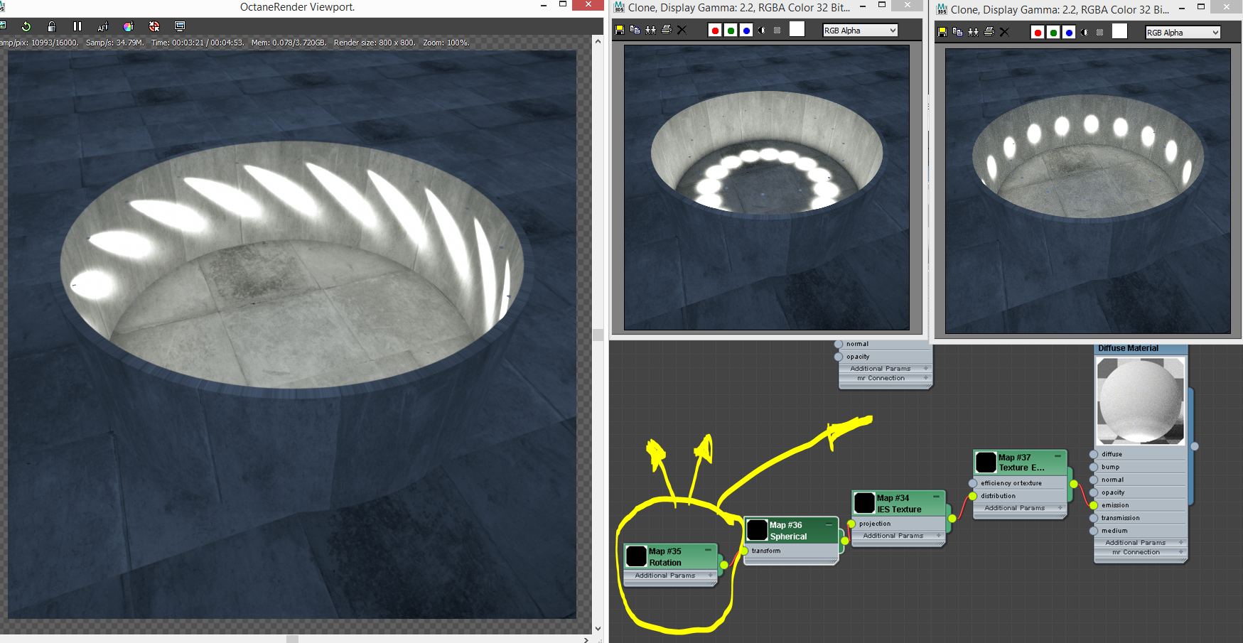

ok now that I know that object space texturing only works with movable proxies (of course!) I finally managed to control ies textures!
I like it.

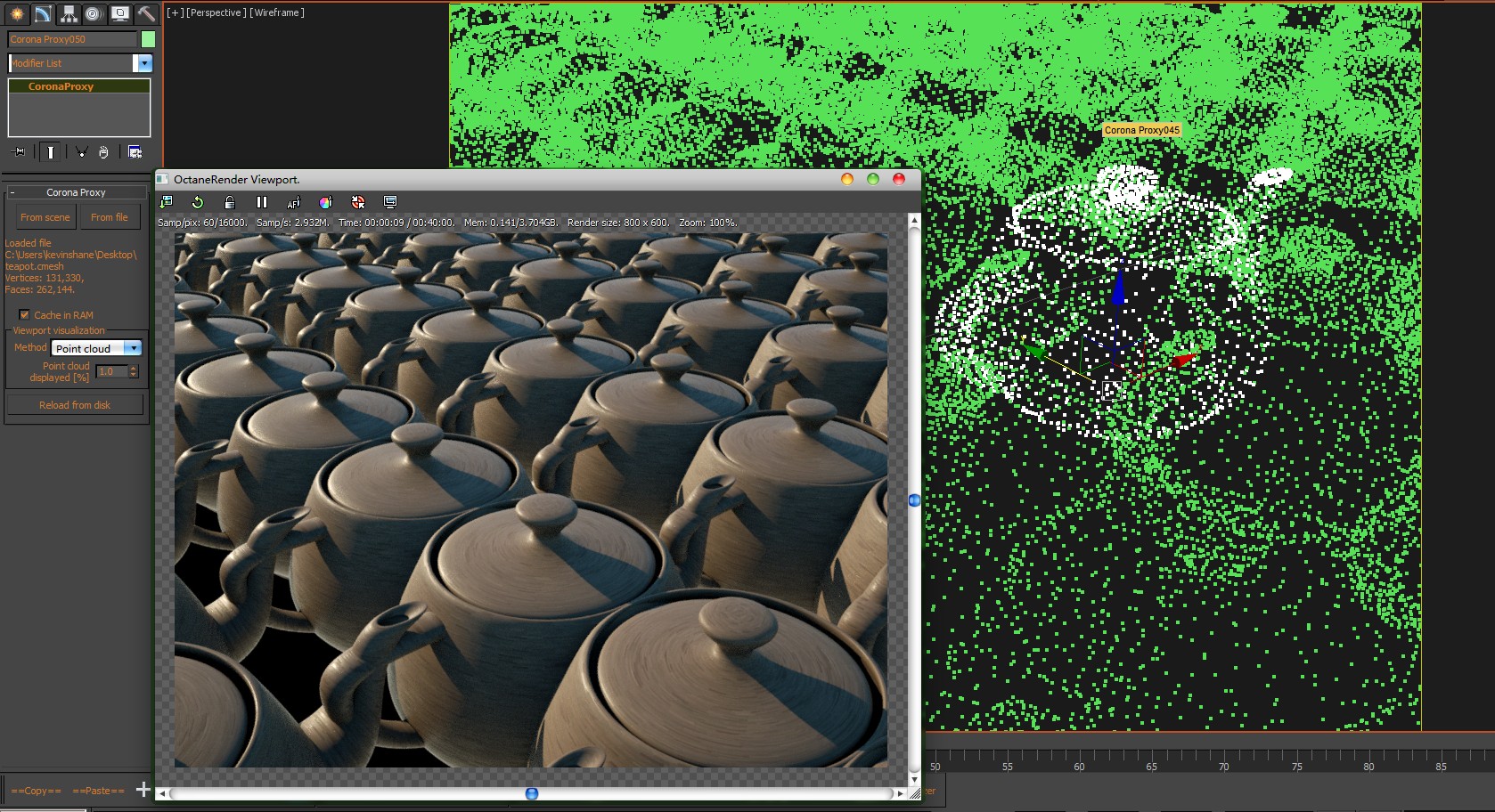

Hi Kevin, i've tried to use your method and it seems that although Octane Render supports Corona Proxys it doesn't support the materials.
I've created a simple teapot and assign an octane material to it, then made a corona proxy and loaded into the scene. Unfortunately any materials showing in the geometry :(
Have you find a solution for it?
Many thanks!
Hi Ibon, I don't have this problem!! But make sure u first assign octane material to that high poly,and then do the corona proxy convert to cmesh file process(which means the cmesh file is an octane material)!
everything working so fine for now,with both point cloud and wire box display option, oh btw make sure all corona proxy objects are check on "octane movable proxy" :idea:
Here is a screenshot with a 64 segments teapot showing the "point cloud" and octane material rendering test :mrgreen: :mrgreen:

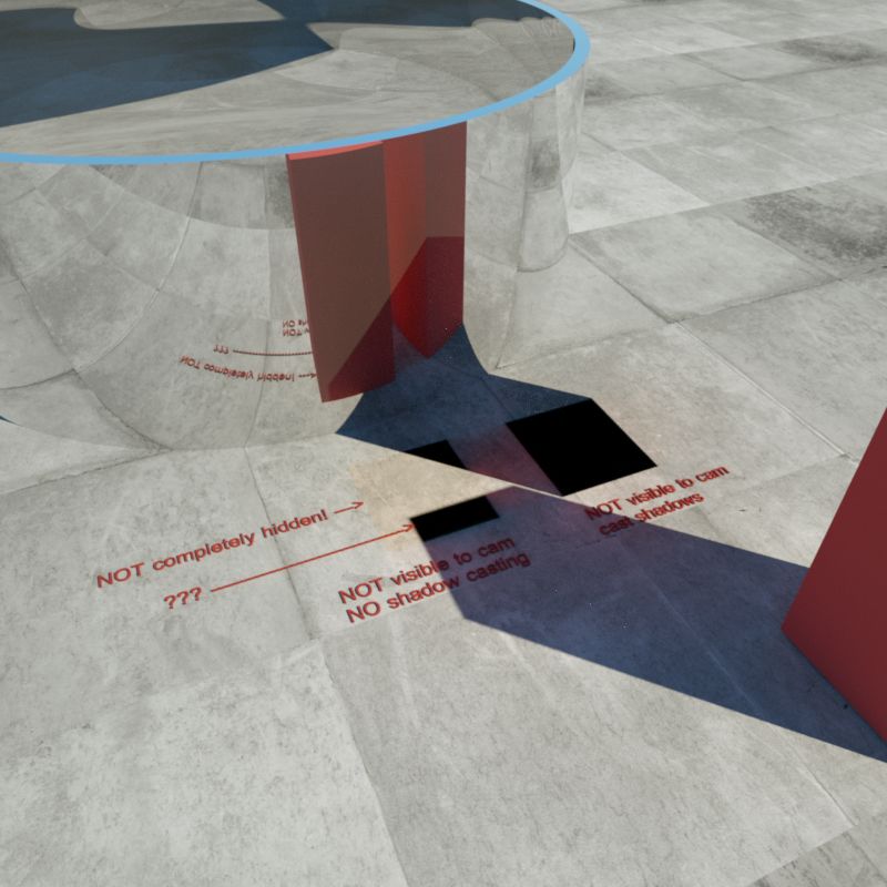

ok me again. sorry I got some spare time right now - that's why.
PMC kernel.
the red boxes are not completely on z axis zero like the plane (otherwise it looks even more strange).
that I cannot get rid of the reflection I KNOW.
but what about the shadow in the non-shadow?

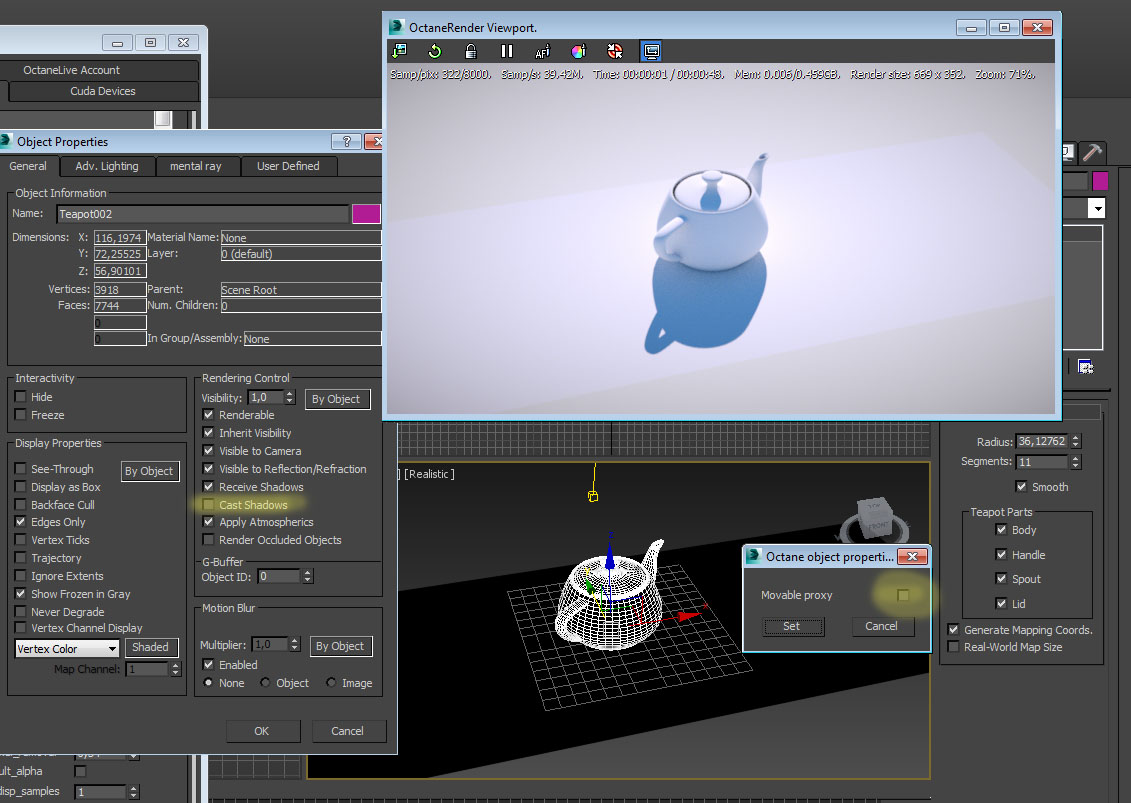

boris wrote:but what about the shadow in the non-shadow?
I can confirm, that turning off shadows is not working.
Is there such feature? Should we be able to turn off shadows? I don't even remember what should be there, cause it has never worked properly.
Suv
it's working but not completely as you can see in my image. it was not working with movable proxies at some point as I remember, I haven't tried that yet.

Ibon_83
Posts: 9
Joined: Tue Jan 07, 2014 12:13 pm
Many thanks Kevin! This is an amazing discovering! Now i can populate my scenes with almost unlimited instances of a high-poly model. Thanks once again!

boris wrote:it's working but not completely as you can see in my image. it was not working with movable proxies at some point as I remember, I haven't tried that yet.
It's not working here at all.
I'm slowly geting tired of this kind of reckless development. :(
