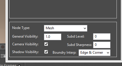

Quick update:
Network Rendering : All Done - works fantastically!
OpenSubDiv : Implemented - you can assign a Subd Scheme in the Settings, and each mesh can have a subd level set (use 0 for the Poser subd vertices), together with a sharpness and boundry setting. This subd is on top of any subd that Poser does to a figure, so watch out - it's possible to generate millions of vertices very easily :-)
Round Edge : Done.
Both the above require your props to have welded vertices (figures will generally be welded). To weld the vertices, select the prop, and then issue the python Weld command.
Paul
