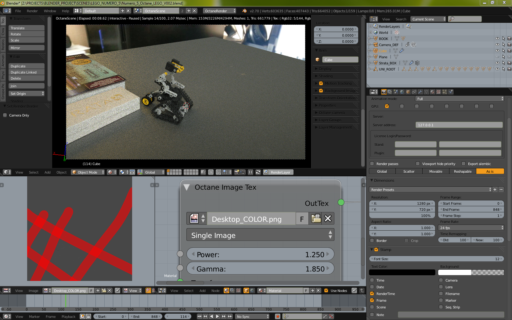

						AhAh, the funny thing, is that you helped me on the same topic some weeks ago if I remember well !
So, I have put a big card board in front of me, over my screen :
For Alembic Export :
1 - ENABLE Octane server !
2 - DO NOT write any file name in the path field. Only type a folder path.
3 - Select the Animation Mode : Camera Only /Movable proxies / Full
4 - Toggle the Export Alembic button.
5 - Select the Kind of object you want to export : Global / Scatter / Movable / Reshapable / As is.
6 - Hit Animation.
If you have an animated object and if you don't select Movable of Reshapable you will get as many input per material as there are frames in the animation ! As I said earlier, I made one time the mistake of not selecting Reshapable ... and I got a node with 2100 input materials !
Good luck !
So far, I haven't yet used the Scatter and As is choices, and I don't exactly know what they do and how they work.
Is it possible to animate scatters ? It would be great for fur on clothes or animals ! As is is a bit mysterious... does it select automatically the kind of object by reading in the Mesh/Octane properties panel ?

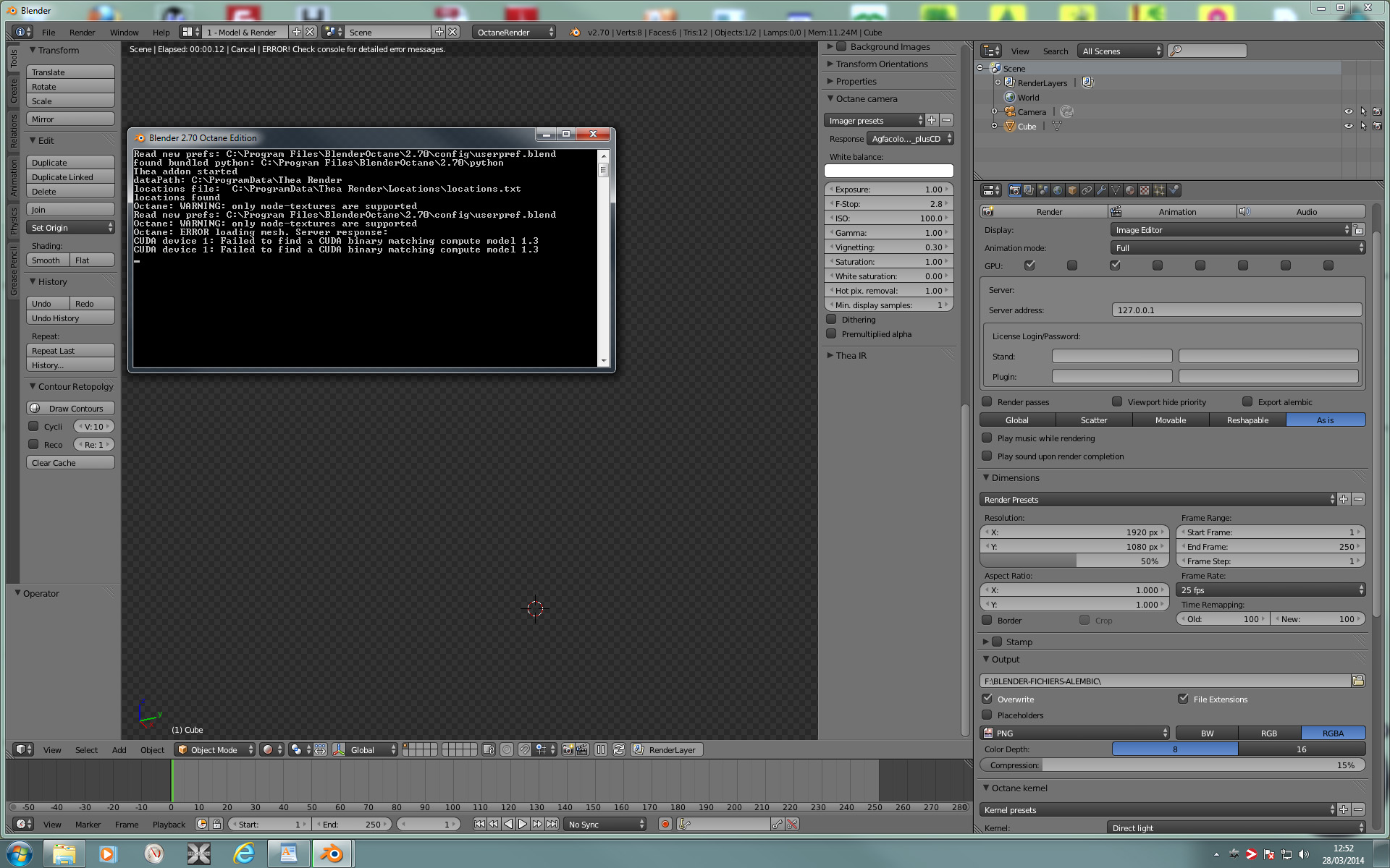

In this case I get a "waiting for image" message, or a" Not connected |No server at adress 127.0.0.1 message". Sometimes I get a render, sometime not.
Often I get a pop up window from Windows 7 saying that Octane has to closed. The server icon is still here, but disappears as soon as the mouse pointer passes over (without clicking).
Octane server closes by itself from time to time and often when closing Blender as well. On the opposite sometimes I can't kill it an I have to right click many times on the tray icon !
I also got the message below in the console. It is weird because My two GTX 580 compute model 2.0 are in position 1 and 3 in Octane standalone Cuda panel and I selected the checkboxes 1 and 3 as always, and only my GTX 260 used for display is a Compute model 1.3 on slot 2, and it is not selected for rendering !
It happens on a simple scene with an Octane specular material. No Blender lamp : scene lit by the octane Daylight environment.
I would also want to say that the lack of display of the number of actually running GPUs Inside Blender doesn't allow to see if there is a GPU failure. The Ms/sec can be an indication but it is necessary to look at it at the beginning of rendering... assuming that all GPUs work fine at this moment.
