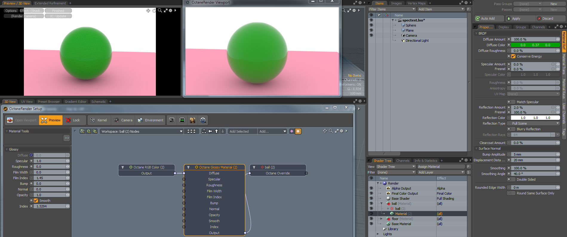

riggles wrote:My MODO material is set to 2% reflection and 50% Fresnel
This should create a glossy node with an index of 1.3294. Specular should be set to 1.0, because the Index is controlling the fresnel curve.

riggles wrote:However, that does raise the question about how Octane handles the glass/specular material overrides when the material has lower reflection and high fresnel settings in MODO.
Octane's specular material is physically correct so the "Index" (IOR) controls refraction and reflection (specular).
Modo has separate controls for reflection and IOR (called refractive index). This allows you to create materials that arent physically correct.
The only choice we have is to use the modo refractive index and ignore modo specular/fresnel/reflection etc

riggles wrote: So, I should just leave the specular value at 1.0 on the Octane material all the time? Maybe I just need a little more relearning when it comes the more physically accurate methods of Octane.
You are free to edit the octane material any way you want once it's created. Paul is just using some simplified rules for the initial conversion (eg. when you dont have an override, or when an override is first created from the modo material). Using Octane nodes will still keep the material psychically accurate automatically because they only allows you to control a limited set of attributes (as opposed to modo which has a large number to cover all bases)
riggles wrote: Octane's "specular" value is MODO's "reflection" value, and I'm not used to having it set that high, for glass or glossy materials.
It's better to think of it another way. Octanes glossy specular (1.0) is modo's reflection/specular color (1.0,1.0,1.0 - note: Paul has decided to only use greyscale values by converting the color to an intensity)
In octane, you need to get used to setting specular values using IOR (Index). We don't have this in modo, but many other renderers do (vray)

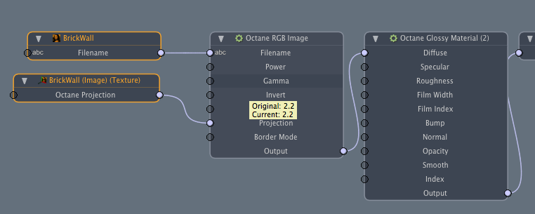

I've also noticed this behavior when adding images from the clip browser versus overriding materials that already have image maps.
For instance, when a MODO material with a diffuse map gets converted, both a filename, projection and RGB image node are created and plugged into the diffuse channel:

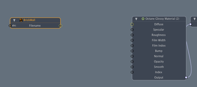

However, when adding an image with the clip browser in the setup view, only the filename node is added:
Shouldn't there be at least a projection node and perhaps an RGB/Greyscale image node added as well? Just the filename node isn't enough to really do anything with.
The plugin does not know if you intend plugging the image into an Alpha, Greyscale or RGB Image, so it simply provides the Filename channel and you do the rest. http://render.otoy.com/manuals/Modo/?page_id=169. Perhaps in the future a popup could be added when you drop the image onto the Schematic to allow you to select "Alpha, Greyscale, RGB or Node".
If there is no Projection node for an Image node - it uses UV mapping.

face_off wrote:The plugin does not know if you intend plugging the image into an Alpha, Greyscale or RGB Image, so it simply provides the Filename channel and you do the rest. http://render.otoy.com/manuals/Modo/?page_id=169. Perhaps in the future a popup could be added when you drop the image onto the Schematic to allow you to select "Alpha, Greyscale, RGB or Node".
Right. I was thinking that if Octane knew enough to create an image and projection node when a material with a texture map was converted, why couldn't it do the same when just a texture map was loaded. But I guess Octane doesn't know how you you want to use that image in that particular case. You could be wanted different projection modes for the same texture in different materials. And default is UV. Ok, got it.
