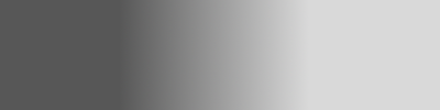

There is a lack of bit-depth in the falloff node combined with a gradient node . when you use a gradient to increase the contrast you can see a noticeable banding. This happens on all versions of octane.
roeland
Posts: 1826
manalokos wrote:There is a lack of bit-depth in the falloff node combined with a gradient node . when you use a gradient to increase the contrast you can see a noticeable banding. This happens on all versions of octane.
It will also happen in all versions of Photoshop. Just paint a linear gradient from light to dark grey. This effect is called the Mach band effect.
You may see less of this effect if you enable or disable the smoothing setting on the gradient node.
Roeland

manalokos
Posts: 443
Joined: Fri Nov 18, 2011 4:43 pm
The attachment gradient.png is no longer available
Roeland

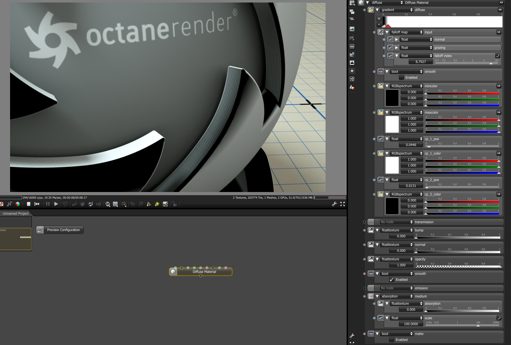

Hello Roeland
I think this is another problem really and not an effect on the computer screen, check this screenshot of a plain diffuse with a gradient and falloff node.
roeland
Posts: 1826
OK, that looks quite bad. We will fix it in the next release.
Roeland
