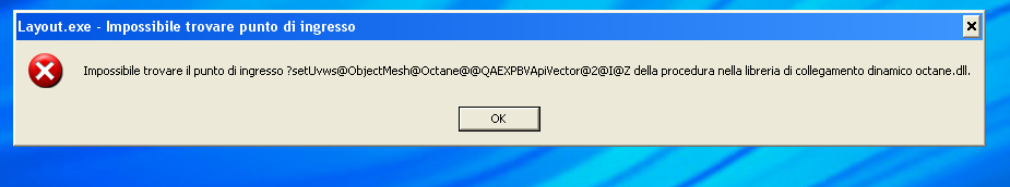

You are mixing the Octane.dll/Octane.dat files with an older or newer version of the Octane .p plugin file. Please, be sure that you have the Octane.dll/Octane.dat files and the plugin file from the same .zip archive.gigi wrote:hi, i have a problem, when I launch the Layout this message appears. depends on what?
-Juanjo
