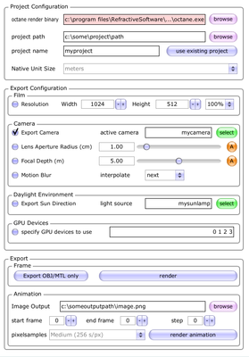

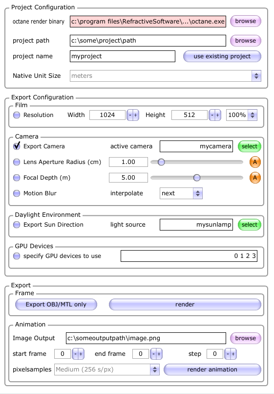

This is the corresponding UI layout that was requested originally:
I think the exporter workflow is also described in the manual (see http://render.otoy.com/downloads/Octane ... l_1_20.pdf, starting on page36).
