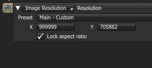

A bug?: image resolution after exceeding 8192x8192 is not displayed properly - see the screenshot.
