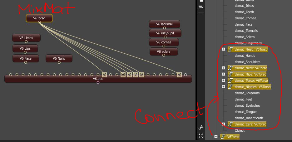

Please help to write a script for automatic connecting mix material(macro) with objects material nodes
example of what i need in the picture

Hi there,
I don't know the exact connection logic you're after but I can give you an example of how you connect a material to a mesh. The next snippet connects a material to all the pins of the mesh. You would need to write your own code to figure out exactly which connections to make:

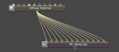

Here's a full test script, just select a material and a mesh and run the script. Afterwards, all the connections should be made:

before running the script
after running the script, all connections are made

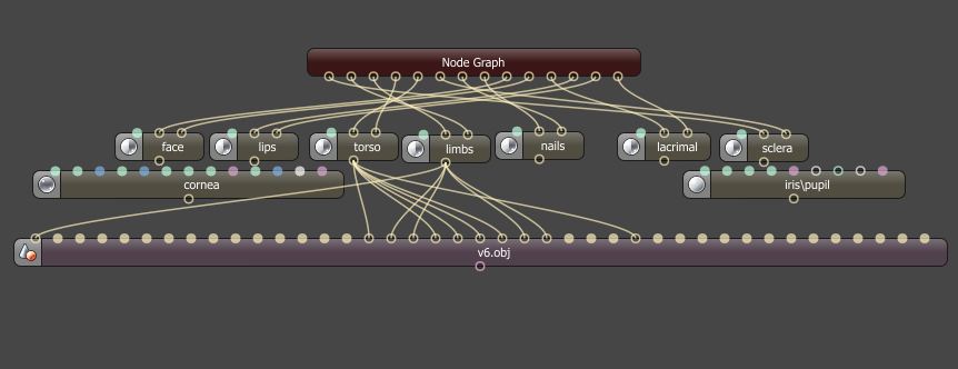

I got several codes for each material
it is possible to unite in one code?

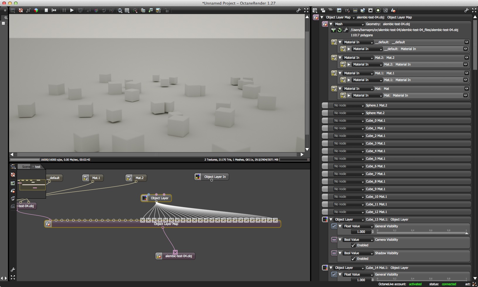

i have tried to convert your script for connecting an object layer node to all the pins of an object layer map node, but it works only for some pins and leaves always the others unconnected:

another question, the best would be to use an "object layer in" node but i'm not able to sobstitute the "Object_Layer" with the input version, where is the mistake?

Slide3D wrote:I got several codes for each material

Yes, it's possible but now you would have 3 things in your selection and 6 different cases to consider...
I'm not sure what you're trying to accomplish with your script? You just want to make the connectios or is there a general rule to which connections to make? You could store a table mapping a material to all the pins on the mesh it connects to and loop over this to make the desired connections.

local selection = octane.project.getSelection()
if #selection ~= 2 then error("an object layer map and an object layer node needs to be selected") end
if selection[1]:getProperties().type == octane.NT_OBJECTLAYER_MAP and
   selection[2]:getProperties().type == octane.NT_OBJECTLAYER then
    Object_Layer_Map, Object_Layer = selection[1], selection[2]
elseif selection[1]:getProperties().type == octane.NT_OBJECTLAYER and
       selection[2]:getProperties().type == octane.NT_OBJECTLAYER_MAP then
    Object_Layer_Map, Object_Layer = selection[2], selection[1]
else
    error("an object layer map and an object layer node need to be selected")
end
-- connect the object layer to all the pins of the object layer map
for pinIx=17,Object_Layer_Map:getPinCount() do
    Object_Layer_Map:connectToIx(pinIx, Object_Layer)
end
Code: Select all
-- Select an object layer map and an object layer in node
local Object_Layer_Map, Object_Layer_In = nil, nil
-- figure out the selection of the material and the mesh
if #selection ~= 2 then error("an object layer map and an object layer in node needs to be selected") end
   selection[2]:getProperties().type == octane.IN_OBJECTLAYER then
    Object_Layer_Map, Object_Layer_In = selection[1], selection[2]
elseif selection[1]:getProperties().type == octane.IN_OBJECTLAYER and
    Object_Layer_Map, Object_Layer_In = selection[2], selection[1]
else
    error("an object layer map and an object layer in node need to be selected")
end
-- connect the object layer in node to all the pins of the object layer map
    Object_Layer_Map:connectToIx(pinIx, Object_Layer_In)
end
ciao beppe
Hi Beppe,
You only start making connections from pin 17 in your code (If you look at your picture, the first 16 pins aren't connected). You should make connections starting from pin 2 (The first pin takes a mesh so we should skip it):
Code: Select all
for pinIx=2,Object_Layer_Map:getPinCount() do
end
The type for an input linker taking as input an object layer is octane.NT_IN_OBJECTLAYER not IN_OBJECT_LAYER.
This code should do the trick:
Code: Select all
   selection[2]:getProperties().type == octane.NT_IN_OBJECTLAYER then
elseif selection[1]:getProperties().type == octane.NT_IN_OBJECTLAYER and
else
end
end
cheers,
Thomas
