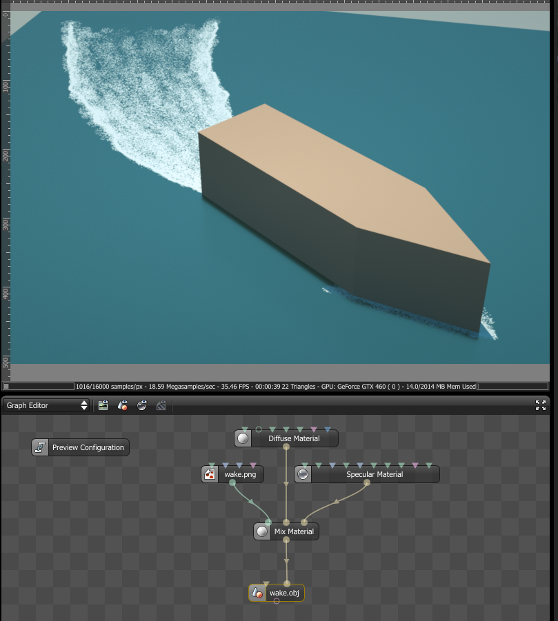

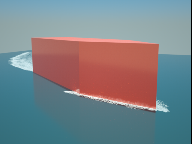

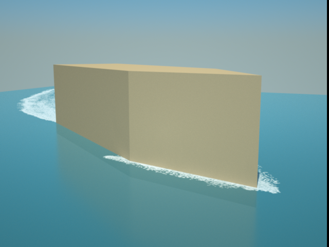

Another possibility seeing as opacity is broken is to use the mix-material in v5 with a specular mat (or glossy with some opacity) for the water and a diffuse mat (or glossy) for the foam. Use the tex to control the mix.
Edit: Replaced previous pics with the same ocean scene ;) This is probably a better solution than opacity map and the water and foam can have separate bump etc...
You just need to refine the tex and fiddle with the parameters to get it looking more realistic. Of course some waves, ripples and swell would help too
HTH ;)
Glossy water with slight opacity
Specular water
Specular water
High view and nodes
High view and nodes

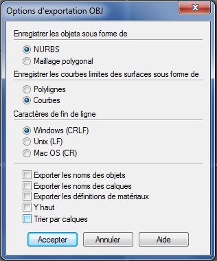

May I ask you for more explanation regarding the export of rhino to octane. I'm very surprised not to find all the options as in your attached picture for export obj. Enclosed a screenshot of my window on Rhino 4.0. I'm sorry it's in french. Are you using the 5.0 evaluation or 4.0 SR8? SR9?
Otherwise I am very annoyed: octane does not endorse layer...
Thank you for your answer, or any other user that Rhino has the solution :roll:

Ok, I'm sorry for the previous post, I found it on McNeel site:
http://wiki.mcneel.com/labs/objio
I hope it will work!
