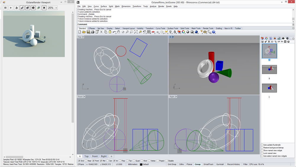

Clicking the Resolution Lock on the Setup tab and then saving the file should address this issue.

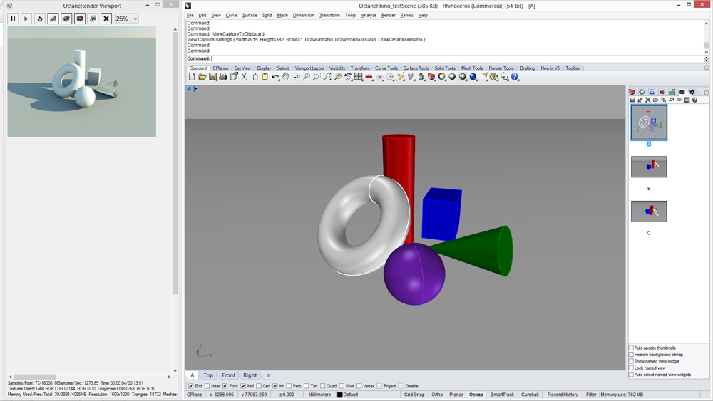

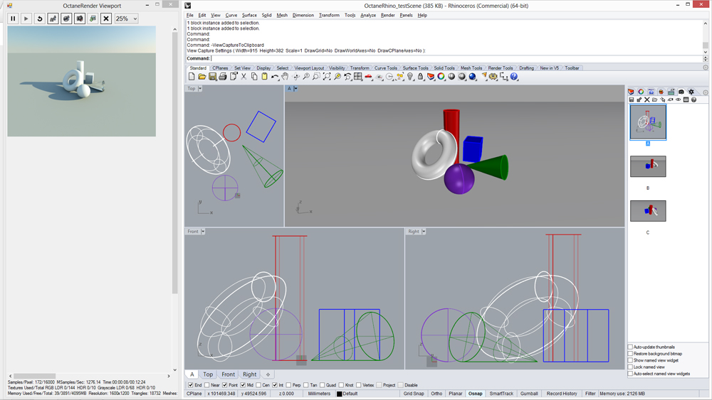

I'll try to describe more clearly. If I lock the resolution to the desired size and launch the octane render viewport, the camera FOV gets modified by changes to the selected rhino viewport. See attached screen grabs.I'm not sure if this is more of a rhino issue, but it seems like the camera FOV is inherited from the rhino viewport directly with no way to lock its value to the render target.
The concern for me would be that if I set up a view and I can't replicate the exact viewport configuration that I had at the time I made the render, there is no guarantee that I can do the same render again.
Keep it up.
-Pete
On the Octane Viewport there is a camera button (Viewport Navigation) - enable it and the Octane camera is no longer sync'd to the Rhino camera fov, position, target, etc. This setting gets saved with the rendertarget - so if you save the rendertarget to the Rhino View - whenever you select to render that View, it will use the saved rendertarget camera settings.
I just did a test. When you enable the octane render viewport's navigation button it does lock the camera properties. BUT if you switch to another named view, the previous named views render target FOV gets applied to the named view render target FOV that you are switching to.
You are right - the Viewport Navigation button status is not being saved to the view. I will fix this for the next release.
Next release has a long list of mods and fixes. It is probably about 24hrs away....
