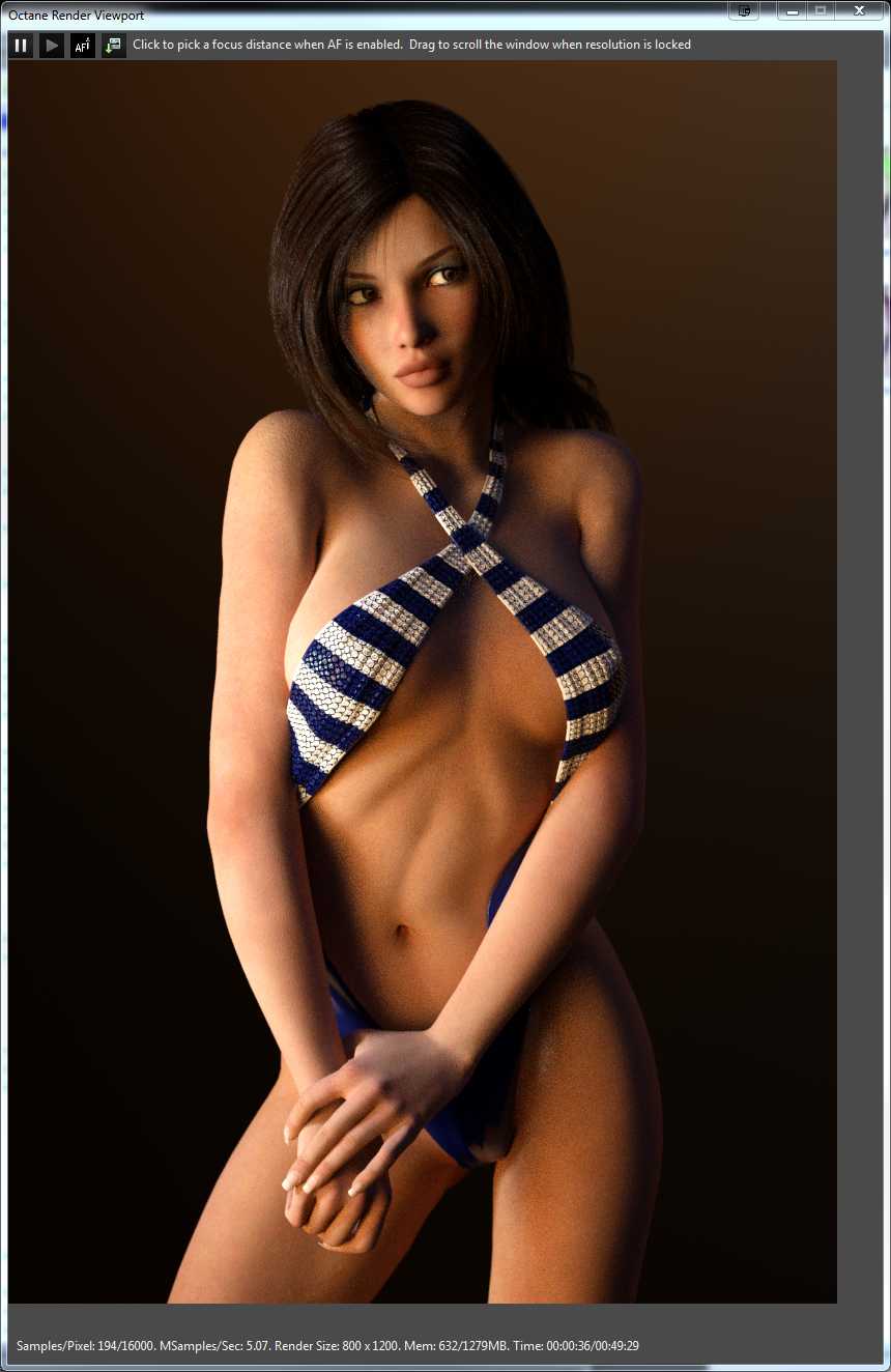

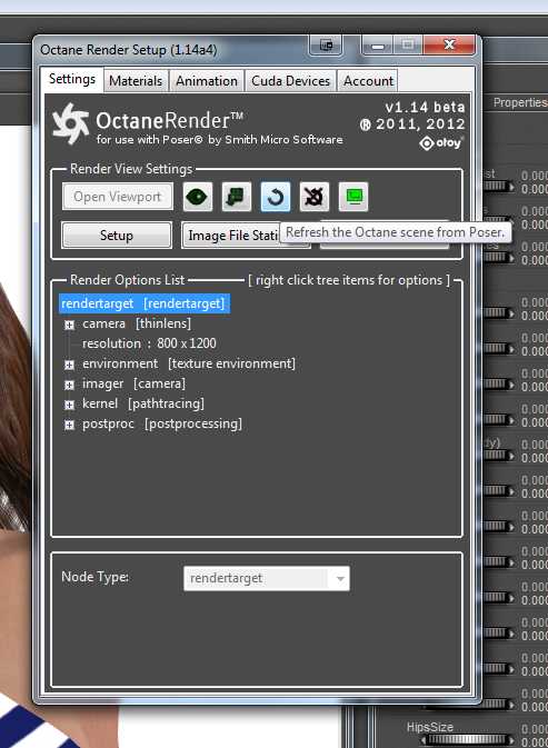

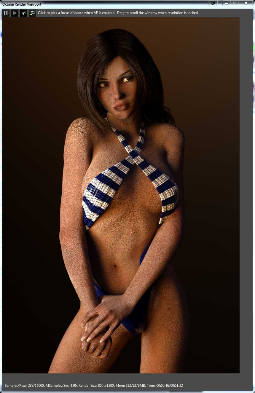

Hi Paul...
Screen captures attached...
The first is your menu item... "Refresh the Octane scene from Poser"
The second capture is what happens to the textures when I play a render in Render viewport.
The third is what I finally get if I use "Re-import the Whole Scene from Poser" from the Octane 'Material ' Tab
It looks like the Refresh is increasing the bump map value somehow. I will look into it. If you just load the pz3, and then open the Viewport, do you get 2 or 3?
FYI...
Refresh the Octane scene from Poser = Reload the geometry of the scene into the Material tab tree structure and re-check all materials have been converted to Octane materials. If the Viewport is open, it will also reload the geometry (vertices) into the Octane scene.
Re-import the Whole Scene from Poser = Reconvert all materials from the Poser Material room (ie. you loose any Octane materials you had previously setup).
Paul

Deane - I had a look and couldn't reproduce the issue. Is it only happening on that scene? Does it happen if you click the Refresh button and the Viewport is open? What about when it's closed? If you Refresh then Reimport from Poser, then Refresh, is the problem still there?
