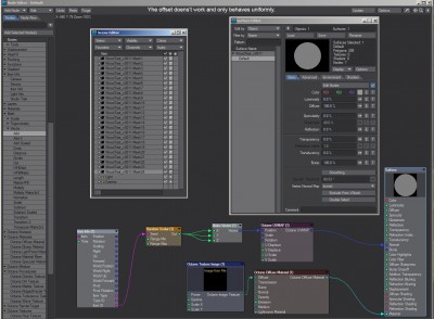

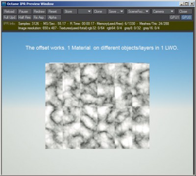

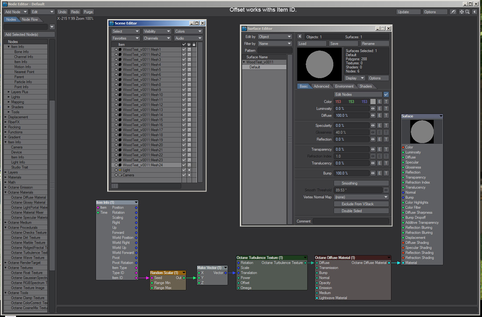

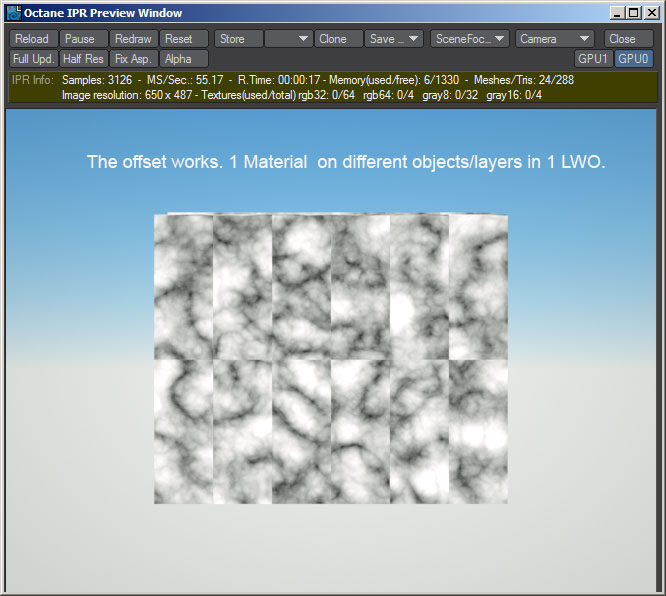

Question:
I like to create an texture offset based on Item ID.
I managed to do this with Procedural Textures. I also tried with Image textures but that didn't work.
Do you know any kind of setup to do this with image textures?
See attached images below for node setup.
It could be very usefull to do lots of objects with the same material. This break repetition in the textures. I think of tiles on the ground. In this case wooden panels. Etc.
Hopefully there is a solution to this. :)
This is the node setup with procedural texture and offset based on Item ID.
This is the result with procedural texture and offset based on Item ID.

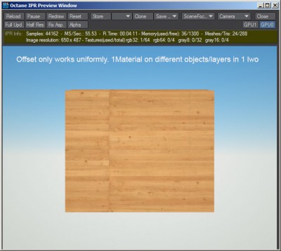

This is the node setup with image texture and offset based on Item ID.
This is the result with image texture en offset based on Item ID.
