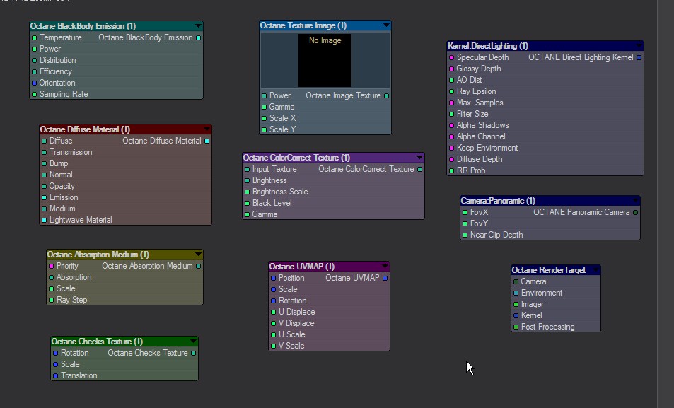

Juanjo - I am afraid I have stumbled upon another much needed feature:
Working with many nodes in Octane LW is becoming a total cluster-f*ck...
and very difficult to quickly figure out what is what...
If there is some way that you could make it so that when we double-click any
node (and bring up the settings) and we can enter a small line of text in a field --
and this overrides the header/name/title/whatever at the top of that node...
this would be huge.
Kind of similar to the ability to rename stuff in standalone - which I miss
quite a bit.
And if you could make the title bar backgrounds different colors - based on
type of node, this too would indeed rock.. and allow us to work even faster.
Help us Obi Juanjo Kenobi... you're our only hope!

Raname the node is not possible, but I can set a color for each node type ... I will add this feature ASAPFrankPooleFloating wrote:Juanjo - I am afraid I have stumbled upon another much needed feature:

Something I didn't know: right click over the node or press "r" and you can rename itFrankPooleFloating wrote:Hmm... it seemed to me that since you are sticking (1).. (2)... at the

OMFG!!!
How did I miss that?.. it is not like I never right-clicked on your nodes...
Oh - you just stuck colors in there.. nice! Those look good to me...
but from an aesthetics standpoint: maybe a tiny bit less saturated...
more subtle pastel type colors.. easier on eyeballs.
Does the whole node need to be colored, or can it just be the title bars?...
I would vote for just bars...
And not to be a further pain in the ass.. but that olive color in the IPR
bar is a little yucky.. maybe something else.
