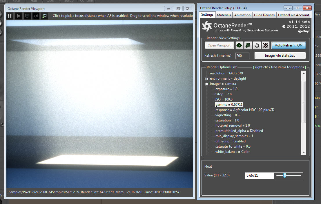

Poser Fog....
You do NOT need to have the normals of the box pointing inwards.
You DO need to use the Direct Lighting kernel.
Tnx to bepeg4d for the sample scene.
Paul
face_off
Posts: 15813
Location: Adelaide, Australia
Another example
