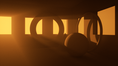

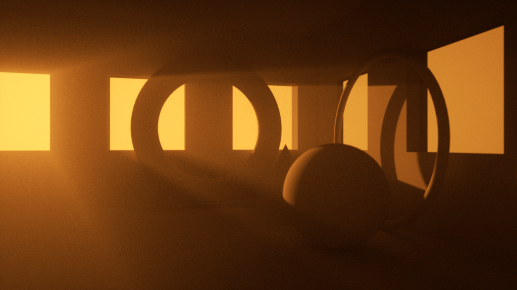

i have prepared a very basic scene that shows the effect, i hope it could help ;)
octane-test-fog-02.zip
(172.63 KiB) Downloaded 438 times
ciao beppe

Hi, I'm trying to get that nice god-ray effect in a scene I'm working on, but I cannot get it to work properly. I turned on Fake Shadows in the specular material, and yes, I get some shadows, but they are REALLY weak, barely visible. How can I increase the shadow effect? I tried playing with the Scale of my specular material, and with the light intensity, but nothing seems to work, the shadows I get are really really weak. I Checked Beppe's scene and I don't get what he has done differently, beside having a sphere inside the volume, which I don't have, because my camera is outside. Any suggestion? Beppe? Karba?

Posts: 10622
hi rick, have you played with the phase value?
it has a great impact on the power of the effect, take care that, with values near -1 or +1, the effect disappear ;)
