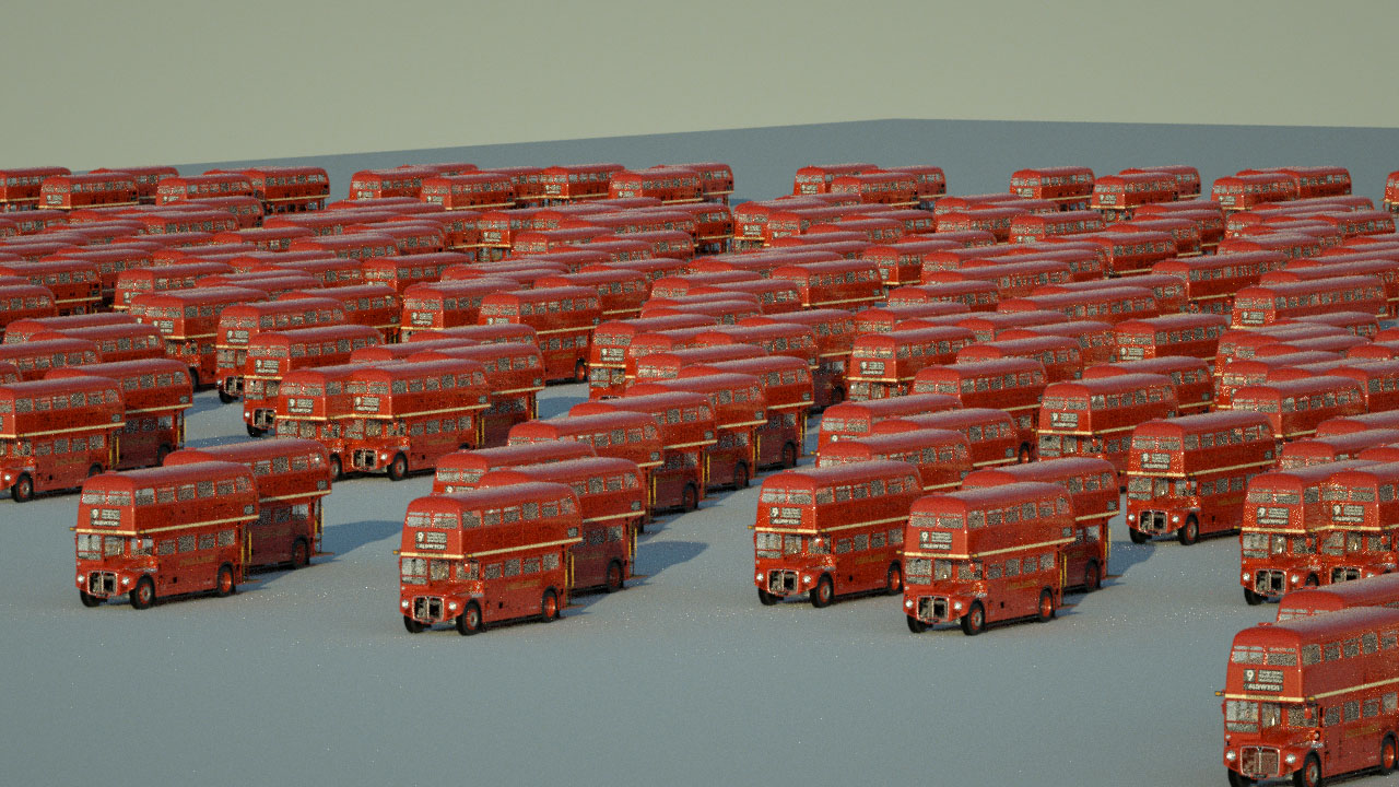

Here is a first test showing 730 Routemaster buses ! This model (currently a modelling WIP) has more than 3 millions of vertices and weights 480MB in 1280x720 format (1150 in 8000x4500). With a good exporter from Blender, vegetation and repeated architecture props should not be a problem any more, at least for still pictures, because the rendering time obvioulsy increases a lot.
As it is, it already helps to multiply some trees for example. I hate using nodes, but these placement nodes are easy to use. Great improvement !
Unfortunately, all materials have had to be adjusted again when importing an obj made with 1.0258e, but in the future this will not be a problem with files made from the recent version..

Looks awesome, that's about 2.2 billion verticesROUBAL wrote:Wow ! Great release ! Thank you very much for this preview !
